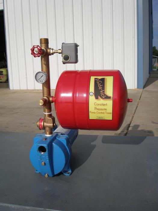

    You may be able to just replace the impeller if it is worn. It might also be just some debris in the jet assembly.
    When those tanks go bad, and they will, you can replace them with a CSV and a little 4.4 gallon tank. This will save you tons of money and space, while giving you better pressure in the house. You will need to get the pump working properly either way.

    Thanks valveman for the reply and the photo!! The CSV and small tank definitely look like a much more reasonable system than all of those huge pressure tanks, and I'm sure we'll want to do that as soon as those tanks fail.
    Are either of the pump problems that you suggested DIY repairs? (As you can probably tell from my post, I don't know much about pumps!)
    Given the local rate for on-site repairs ($100-150 trip charge, plus $100-150/hr labor), I wonder if it would be more cost effective just to swap out the pump with a new one?
    We can get a new Goulds pump for $500-600, so it would probably cost $1000 installed.

    BTW, would a CSV be compatible with our current pressure tanks? If so, we'd like to install one of those now, regardless of what we do with the pump (repair or replace).

    Moray, yes you can install the CSV even with the big tanks. Just need to set the CSV at 58 PSI when used with a 40/60 pressure switch, so it doesn't take too long to fill the pressure tanks.
