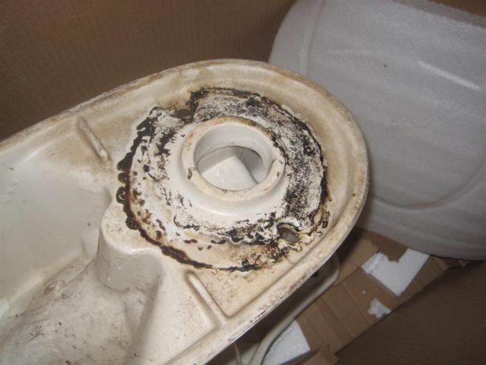

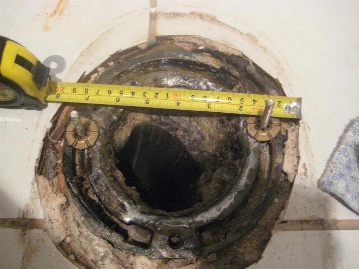

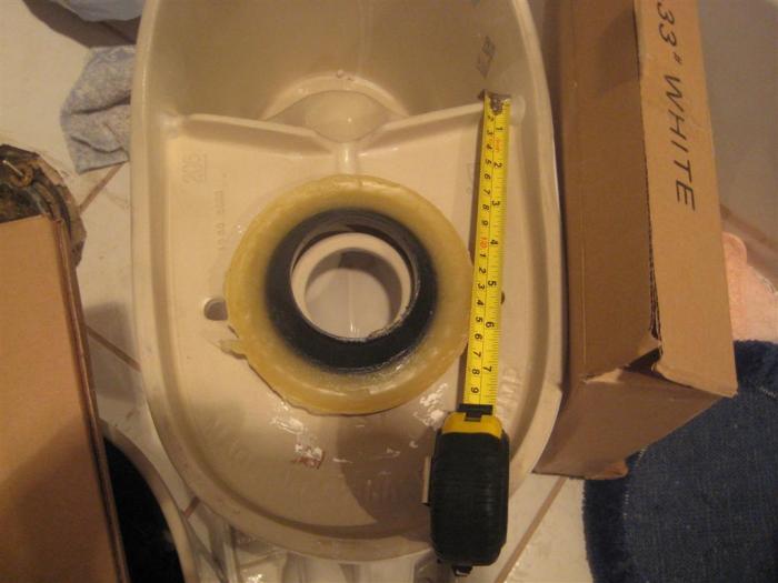

Hi All,
After almost every possible leak a toilet can have being repaired, I finally gave up because I couldn't find a proper gasket to go between the tank and bowl of this toilet that is ~30 years old.
Bought a new toilet, took the old one out, tried to put the new one in, and it wouldn't stick.. Aligned the bolt holes and set the new wax ring on the bottom of the toilet but it never makes contact with the flange.
Problem I think, is the flange is level with the tile floor, or maybe sitting underneath it by 1/4 to 1/2". When I set the toilet down and move it around I can just hear/feel it hitting the tile and not compressing the ring like it should. See pictures..
The bottom of the old toilet looks like the older ring was a LOT wider than this one, is that normal? This is the 1st time I've replaced a toilet and expected it to be easier..
Can anybody give me some advice on how to make this new toilet fit properly?

You need to fix the actual flange. It should be on top of the finished floor. Since that is impossible without replacing the floor and pipe at this point, your best option is flange extenders. Silicone them together and screw them and your existing flange tight to the subfloor. Get rid of the wax ring with the plastic horn on it too.
Flange extenders...or, stack two wax rings together. As noted, the 'proper' place for the flange is on TOP of the finished floor, anchored through it, with no gaps between the floor and the flange. A flange is normally in the 1/4" thick range (plus or minus a little). That should help you decide which extender(s) you need to raise the flange unless you go for just stacking a couple of wax rings.
Gary Swart
8,101
84
Yakima, WA
I would opt for the extenders rather than double wax rings. Although that is sometimes done successfully, that much wax has a tendency to leak after a time. Just bring the level of the flange up to slightly about the level of the floor, use a regular wax ring, no plastic funnel, and you should be fine. Those plastic funnels are a joke. The usually cause problems and never fix one.

I would try the fluidmaster gasket that Terry uses. He uses it so it can be reused as he changes toilets for testing and avoid the mess of the wax but I use it because my flange is too low. I use it on 2 toilets and I haven't had a problem in 3 years using this product. They have two o-rings in the package, 1 for 3 inch and another for 4 inch waste lines.
You can see it on the home depot website under toilet maintenance & repair. You don't compress or rock the toilet because there is no wax. A very simple fix compared to working on the flange.
I can also vouch for what Gary wrote about double stacking wax eventually leaking. This is why I went to the fluidmaster - it is a plastic funnel that Gary seems to deride but it does work - at least in my situation. I also tried the one where there is very flimsy plastic with the wax - very similar to what the op shows in the picture. That one IS a joke. I tried it before the fluidmaster and it didn't work. The fluidmaster is sturdy plastic.

The gasket sound interesting. I will have to check that out. You could also try an extra thick wax ring (#10) - it should reach no problem. I agree about not using two rings.

Non-drying plumbers putty, grab a lb bucket and roll up some in your hand to get it good and warm and then make a donut out of it the diameter of the flange and thick enough to make the connection between the flange and the water closet.
Section 890.360 Water Closet and Pedestal Urinal
Fixture connections between drainage pipes and water closets, floor outlet service sinks and pedestal urinals, and earthenware trap standards shall be made by means of brass, copper, hard lead, plastic, or iron flanges; caulked, soldered, screwed or solvent welded to the drainage pipe. Flanges of hard lead, plastic and iron flanges for no-hub or compression joints shall be secured to the floor. The connection shall be bolted, with a gasket, washer or setting compound, between the earthenware and the flange. The floor flange shall be set on an approved firm base. The use of putty or non-drying plumber's putty manufactured specifically for plumbing installation is acceptable​
