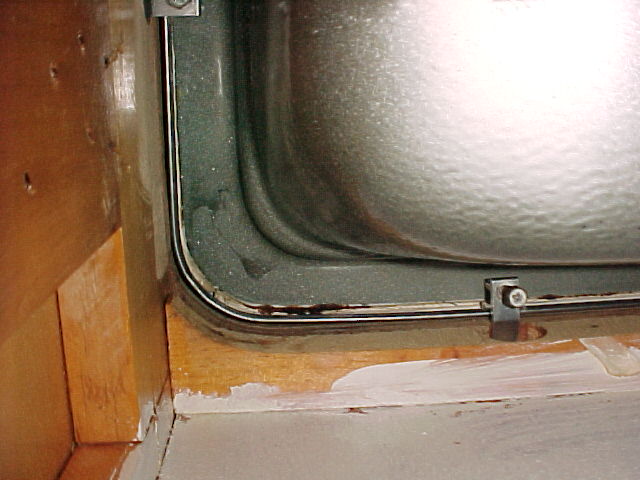

never tried this before, want to install stainless steel sink, but, cant get the old metal rimmed sink out ( my husband put that in a few years ago). tried to loosen metal rim with a putty knife thinking caulk was stuck like glue (it is white, so I am assuming he used caulk)- but no luck - looked on the internet, no luck, only read i was lucky the sink didn't drop on my sons head who is trying to help me get that sink with the sprayer i have my heart set on. (I don't remember his dad using any 2 x 4 to keep the porcelain sink from dropping into the cabinet - saw that on the internet also) - So reconnected the water lines and drain pipe back to the old sink- and walked the new sink back to the barn - any words of wisdom?

first I want to thank you for the reply. My son removed the clamps from underneath the sink, then ran a putty knife carefully just under the rim between the rim and countertop to loosen the grip of the caulkin, expecting the sink and rim all still attached to come up as one unit. The sink and rim did not budge. When you look under the sink through the cabinet, you can see a nice bead of caulk between the edge of the rim (the only thing i can think of to call it is the channel piece of the rim the sink edge sits next to) and the actual sink. The countertop is formica (that sounds dated), and we are trying to put in a rimless stainless steel sink). My brother in law, suggested as a last resort to use a jack to help lift up the sink - that seems like an extreme measure - dont want to damage my countertop trying to get the sink out - does that give you a picture of whats happening?

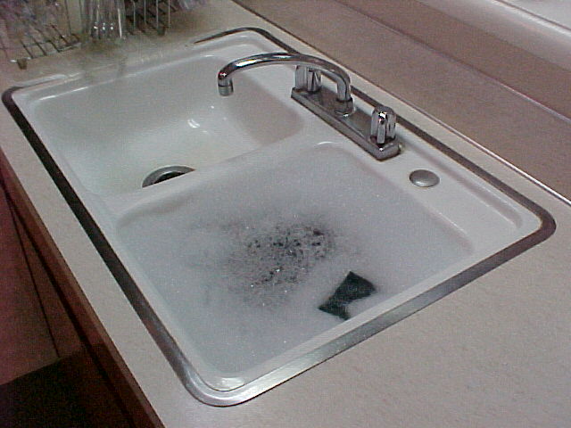

yep, my metal rim - is your hudee ring 0)- i saw those pop out tabs - on the hudee ring underside, at first i thought they were some kind of nail - but they are a sharp metal tab that is sticking out - so we didn't push those flush with the metal ring under the sink - we left those alone - but, i do see a nice bead of caulkin between the ring and sink lip (edge) underneath - so even if we had pushed the pop outs down, and the clamps were removed (which they were) that caulkin would have kept that sink in place in the ring wouldn't it??? we thought the rim and sink would lift out all in one piece. so if, we push those tabs down - is it the consensus that the sink will drop? "bear with me - appreciate your patience - told my son, if your dad were here, i would leave the kitchen and come back in when I could use my new sink - 0) - a picture is worth a thousand words, the 2nd pic shows that caulkin bead - under the sink - well, before i further muddy the water - if i did this right - take a look

The hudee ring lav sink I did last didn't have any sort of temporary retainers that I could understand. When I was reinstalling it, I had to hold the cast iron sink while my wife fit a couple of clamps finger tight.
Anyway, when you're done, make sure you save the ring, clamps and sink and put it on Kijiji or Craig's list or something -- there's a market for those retro sinks.
Frankly, I think yours looks pretty good in the picture -- you could replace the faucet and be good to go. Even take it out and have the porcelain enamel re-done and have it look better than new. The porcelain enamel cast iron jobs are really solid hard-wearing sinks.
I think the caulking is holding the sink in place like a good glue. It will likely take some force to remove it and you risk delaminating the formica around the sink area and possibly even splitting off some of the substrate.

ok, uncle - i don't want to ruin the countertop trying to get the sink out - cause that would be more of an eyesore than the sink - and you're right, that side of the sink does look pretty good 0) - it is the side under the water that the porcelain finish is gone - guess i couldve drained the sink - but wasnt thinking about that, ha. thanks fellers - think i will hang up my plumbing pliers 0) new faucet is an idea - got that and now after messing around with it - the left side of the sink under the sink basket IS leaking just at the top of the threads under the basket - oi vie' - well, i never used that bowl anyway
