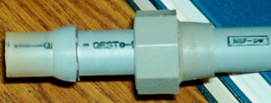

We have a old Kinetico Model 30 system in our house. I believe the system is over 20 years old (same age as our house). All I want to do is uninstall/remove it. I have no instruction manual of it and Kinetico web site and Google didnt help. The system is not electric and has two tanks. I think this is the one: https://terrylove.com/forums/showthread.php?t=2992
It has these gray adapters(?) on it: www.*******.com/8pwvfp
What are these called?
Can anyone tell me what steps should I take to uninstall this system. I will later replace it with another system but thats a different issue.

It has these gray adapters(?) on it ...
Those are possibly Qest fittings, and my own Kinetico has the same. They are like big compression fittings with standard pipe threads on one end for connecting to the incoming and outgoing supply lines. To remove them after turning off your water and de-pressurizing the system, unscrew the big nuts and pull the gray tubing away from where the nut had been fastened. You will ultimately end up with pipe threads on the ends of the incoming and outgoing lines where the softener used to be, and you will need to plumb those two lines together.

Thanks. Yes, it does appear to be Qest fittings. How do you depressurize the system?

After shutting off your pump (if you have a well) or closing your main valve (municipal supply), just open any convenient tap or faucett to de-pressurize the entire house ... then close that tap or faucett to help reduce the amount of water that will begin running out when you begin disconnecting lines.
Thanks. I guess that would mean I should do this when I am ready to install the new unit.
Also, my Qest fittings are on copper piples. Do I use a regular wrench for it or does it come with special wrench. I am assuming its just like a regular nut.

QEST fittings are great and very easy to use, only tighten the nuts until they squeal and then a 1/4 turn; do not over tighten them. Actually they do not have pipe thread, the threads are not used to make the seal, the white piece in the picture seals against the fitting's seal surface and the nut forces the two parts together. The SS retainer ring, and nut, then holds the pieces in place. You can also use Shark Bite fittings.
Yes, if your bypass valve does not leak and you want to just bypass the softener for now. My bypass valve likes to leak a bit when I occasionally use it, but turning it back and forth a couple of times usually solves that problem.
The Qest nuts will turn loose and unscrew from wherever they fasten, but it sounds like you are going to have to do some soldering (or have some soldering done) in order to remove them altogether and to then either install a new softener or add a straight-through piece of new pipe.
