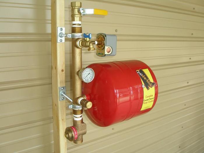

    Our well guy just finished drilling today and got us 15gpm at 220ft. It's not as much as we hoped for but will work for our domestic and 3/4 acre mini farm. I'm hoping for some input on the pump detail if anyone help.
    I really like the driller but don't have all that much cash to spend on the pump as the drilling/casing is already about $9000. He's suggesting a Franklin quickpac 1 1/2hp. constant pressure system with tank, drop pipe, wire and a few other details for a total of $3600.
    This is quite a lot more than I wanted to spend and I'm not really sold on the Constant pressure system. I don't mind building and insulating a well house and using a large tank but from reading online here about a CSV I thought maybe we could use a smaller tank and just a regular 3 phase.
    Any suggestions and recommended pumps/controllers would be more that appreciated.

    If your pumping level is 220', then you need a 15 or 18 GPM, 2 HP submersible pump. Use a regular 240V, single phase motor and control box. Hang the pump on some 200 PSI poly pipe and use 12-4 or 12-3 with a ground for wire. Then all you need to control it is a Pside-kick complete pump control kit, like the one pictured below. These are designed to replace the Quick-Pac. The Quick-Pac is an expensive and short lived variable speed system that is designed to make Franklin Electric a lot of money at your expense. The Pside-kick uses a Cycle Stop Valve to replace variable speed controllers. The CSV will increase the life of regular pumps and gives better constant pressure control than variable speed systems. Pump guys who are still using variable speed systems just haven't had enough experience with them to realize that they will destroy their reputation. Variable speed systems are old technology. We learned all the problems of variable speed systems and stopped using them completely in 1993. There are a lot of things about Variable speed technology that mother nature won't let anyone fix, so these systems will never be problem free.
    I don't see how Franklin can continue to sell these systems for so much money. You can buy a variable speed controller on the Internet for $200 that is far superior to the Franklin units. However, these other variable speed systems still have all the same problems. Search this site for "CU301". This is a Grundfos variable speed controller that much better than the Franklin systems but, are still being replaced by the CSV on a regular basis.
    The best use of new technology is to be able to research the problems of new technology. You are smart to be asking these questions and studying the alternatives before you get stuck with a "tar baby".

    If the well will only produce 15 GPM, then that is all you have to work with. That is plenty of water for the house. You will just need to limit your irrigation to 15 GPM, if you can irrigate during off peak times for the house. If you must irrigate during times when the house may need water, I would not use more than 10 GPM for the irrigation.
    Your pump supplies the water. The pressure tank is just to keep the pump from cycling on and off too often. With a CSV you don't have to worry about cycling, so a very small tank is all you need. The pump has to be large enough to supply the demand, a larger pressure tank will not help that at all.
    If 15 GPM is not enough to supply your needs, then a cistern or storage tank would be needed. The well would fill the cistern, and a separate pump would supply water out of the cistern at a flow rate higher than 15 GPM. I think 15 GPM is plenty to do everything you desire. You just may have to run 5 or 6 sprinklers instead of 7 or 8 at a time.
    So we've been looking at the CSV website and think that a 34 gallon tank would keep the pump from cycling often and yet cover us in case of an irrigation leak. Input please?
    We've also set our sights on a 1.5 hp. 19+/- gpm. 4" pump with a Franklin motor but wonder if anyone has a suggestion on a decent quality, low cost unit.
    Thanks,
    Mark
    Moderator valveman's Avatar
    Mar 2006
    Lubbock, Texas
    The 1.5 HP pump will give you about 14 GPM at that depth and pressure. That should be fine. Nothing wrong with a 32 gallon tank. That tank only holds about 7 gallons of water. You are really not helping anything by going any larger than a 20 gallon size tank but, it won't hurt a thing.
