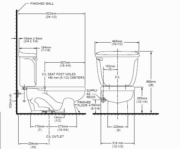

I am a little person who only measures 4 feet. I am in search of a short toilet to add to my washroom. I have come accross the american standard baby devro but it is only 10 inches wide. I am looking for something larger but as short. Do you have any suggestions as to where I can order one from/what company I should be looking at? It's for a home install.

Peanut9199
869
Ontario, Canada

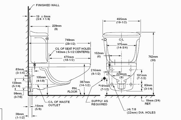

An alternative may be a wall mounted toilet. While not a typical residential installation, they are not unheard of. It would take a small remodel to get the wall support installed, but it would stop your feet from dangling.:)
I checked with my Duravit in-wall carrier system and the lowest i could make it was 15"
The American Standard wall hung bowl only is 13 3/4" to the rim (not including seat).
Peanut9199
869
Ontario, Canada
Also checked the Flush valve style wall hung toilet and it is 13" to rim bowl only no seat.
and if you want to see the Duravit:
