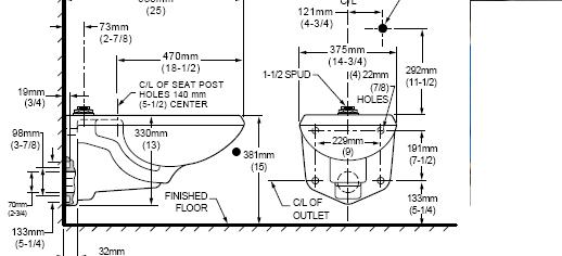

    Also checked the Flush valve style wall hung toilet and it is 13" to rim bowl only no seat.

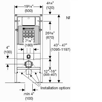

    and if you want to see the Duravit:
