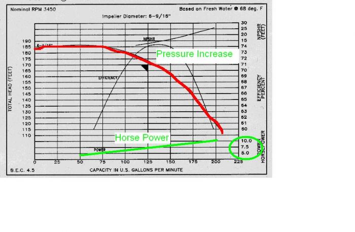

    I don't understand why a cycle stop valve works. I have some small knowledge of motors, and have rebuilt a few 1/2 to 2 H.P. 110/220VAC single phase woodworking motors. But I don't understand how restricting the outflow of a pump will make the pump motor work easier. Anyone care to help me understand this?

    Pumps with centrifugal impellers are "counter intuitive". The more you restrict the flow, the lower the amperage or power consumption. You would think that choking back the flow from a pump would make it work harder but, this is the opposite of the truth. Study the typical pump curve below and you will see that power consumption is proportional to the flow rate, and that increasing back pressure does not waste energy. This pump curve shows a pump that will use 10 HP in energy when pumping 200 GPM but, will drop to 4 HP load when restricted to about 50 GPM. The same proportions are true with smaller pumps. All centrifugal pumps have this magical ability. The CSV just allows you to take advantage of this natural phenomenon.
