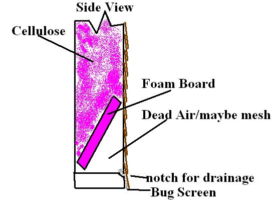

    Another thing I am wondering about is a two-fold approach, much like is discussed on the other board. What if, I was to remove the bottom 1' of siding, intall some foam panels about 1' high in such a manner as to create a stop, so that the cellulose wouldn't be allowed to settle at the bottom of the wall. My thought is I woul get good fill for 99% of wall, but if any moisture did accumulate, it could settle, via gravity, towards the bottom of the wall and then mitigate out the wall. I have attached a crude drawing.... Only problem is, this might put too much water on the bottom plate....
    No advantage, compared to just filling the wall. Without the airspace behing the cladding, there's no drying mechanism. And moisture doesn't settle via gravity, the way bulk water does. If it did, your foam stop would also stop the moisture, re-directing it towards the inside...

    frenchie, thank for clarifing my mistake in the "baffle" idea. I wondered if it would work. I think my next step is to call central inspection and speak with an inspector to possibly see what they say as well as see if I can reach someone with the local Dept of Energy. Maybe they can tell me about cases locally. From what I gather the vapor barrier really is less important in my climate than in some. We aren't overtly rainy, dry, or humid we aren't on the extreme, extreme cold or heat sides, we just get a little of all of it.
