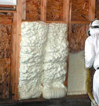

    I have applied polyurethane foam for insulation my home.. There are two types of spray foam insulation: open cell and closed cell. Closed cell insulation typically has a higher R-value, so you get more bang for your buck. Spray foam insulation is expensive and durable. The product is more expensive inch for inch, and requires installation by a professional. It's sprayed in your walls as a liquid, then expands and hardens. Spray foam insulation is great because it fills every little nook and cranny creating an air tight seal. It doesn't biode grade, so once installed it will be there for the life of your home. It also doesn't shrink or settle. Spray foam is a great option if you're sealing small spaces like outlets, around window frames, and doorways. Choose best spray foam-e.gultimate linings, qwikliner , xtreme liners etc.

    khali, the picture you posted is of a HALF POUND (per cubic foot) density spray applied foam, it is the cheaper, less effective of the two.
    The other option is TWO POUND (per cubic foot) density spray foam, when you spray apply this it expands within seconds, not minutes, and if the guy using the gun knows what he is doing you wont need to do the ridiculous amount of trimming that half-pound foam requires.
    That is a finished product after spraying 2 pound density foam, it doesn't expand in huge plumes and can provide R7 per inch.
    Half pound foam is junk.
    Neither of them can be installed in any large volume by a home owner, it's never going to be feasible to try to buy little cans, or propane bottle diy kits and do an entire house, this is a job for PROFESSIONALS.
