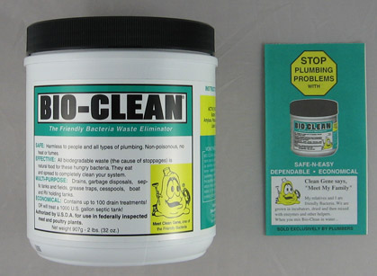

    Default Not draino
    This will also clean your pipes good but needs to be used on a regular basis:
