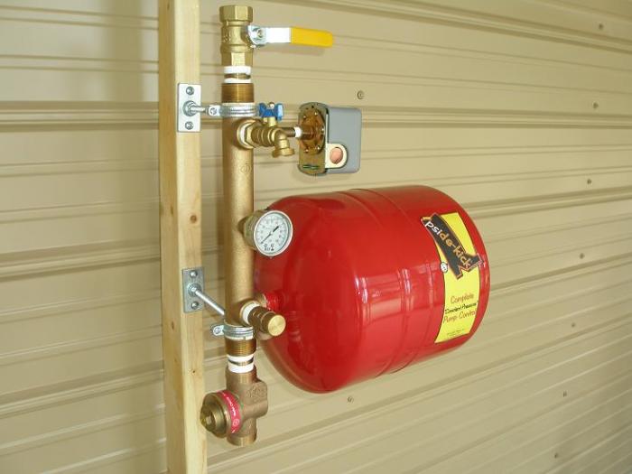

    I think your bladder is busted and over time, more water gets on top of the bladder and increases the pre-charge pressure. Like Gary said, check your pre-charge pressure again. That pressure will not increase by itself. If the pressure is higher than you left it last time, the bladder is busted. That being said, your tank was too small to start with. You should get a minimum of 1 minute of run time to fill the tank. 40 seconds means your tank is too small.
    However, big pressure tanks are the old way of doing things. Constant pressure systems with very small pressure tanks are becoming the norm. A Cycle Stop Valve gives you the run time required and eliminates cycling, so big pressure tanks are no longer needed. Cycling is what destroyed the bladder in your tank, and you should be aware that you pump has cycled enough to also be on it's last leg as well.
