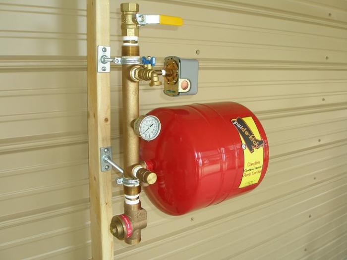

    I got my well drilled last Fall. It's 170 feet deep, cased to 105 feet, and water level is 50 feet. I'm in SW Missouri in the Ozarks.
    Here's what I have right now:
    I would like to get water to my (non-heated) barn, which is 40 feet to the East of this well, and sometime later get water to my house site which is going to be located 80 feet NW of the well. The house site is about 10 feet lower in elevation than the well and the existing barn. I have a good deal of construction experience, and am capable of building a good wellhouse, but do I need a wellhouse? Ideally I'd like to get water to my barn this Spring, but I won't start construction on my house for another 2 years.
    Is there some way I can put a pressure tank in my non-heated barn, and be able to drain everything in the late Fall when temps drop so nothing freezes up, and then be able to turn the water back on in the Spring without building a wellhouse?

    If you have the pump down the well you don't need to put anything over the well. Just run an appropriately rated wire from the barn to the well, sized for minimal voltage drop at the required current. Also bury the water pipe below frost depth. Code dictates a minimum depth for the electrical. Use pitless adapter to bring the water out the side of the well casing at the depth you want to run the pipe. Use nice big black flexable (sort of) pressure pipe. Probably want 1.5" or so. Bigger is better to minimize pressure drop.
    Tank and pressure switch go in the barn. Leave drain valves at low points to drain everything. Maybe put something at a high point to let you put in compressed air for blowing out the system with fewer drains. Try to avoid making low points in the plumbing.
    When you get the house done you just move everything. Or build a protected space with some backup heat around the tank and pipes in the barn and run more buried pipe.
    If someone here would comment on the proper use of a check valve. It would seem useful to have a check valve before the tank and pressure switch rather than have one at the pump. Then a valve on the pump side of the check valve would let water drain back into the well.

    Actually, your last suggestion is not a bad idea, as long as no one ever shuts off that hydrant while the pump is running. Of course after the pump is shut off, you will have to close the hydrant to get it to drain or the hydrant itself will freeze.
    You apparently already have a pitless adapter from the looks of your casing. The well driller could have put in an H2Optimal system that has larger casing at the top of the pitless. This allow for the pressure tank, pressure switch, and Cycle Stop Valve to be installed inside the casing. This is done a lot for stock wells that are out in the middle of nowhere and do not have a well house.
    Since the well is already finished, you could use one of H2Otimal's Buried Tank Eliminators. This is buried next to the casing and has the pressure tank, pressure switch, and CSV inside and underground. This way when you are ready to hook up water to the house, barn, or irrigation, all you have to do is run the water lines. The CSV allows you to use a very small tank, and the BTE puts it all underground where it cannot freeze.
    You could also use one of the Pside-kick complete pump control packages inside the bran or house. (See picture below) You would just need to install a stop and waste underground before the pump controls. Then when you need to winterize, you just turn off power to the pump, and close the stop and waste valve.
    You DO NOT want any check valve in the system other than the check valve that is on the pump itself.

    Valveman, there is nothing there but a hole in the ground, and the casing and the green cast-iron cap on the casing. All the driller did was drill the well and drive the casing, and seal it with some 3 bags of clay.
    I like the idea of the Pside-kick pump control package as in the picture you posted. It looks simple and I like simple.
