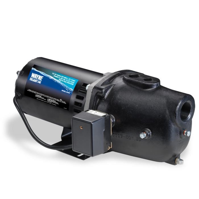

    It is a Wayne Reliant 1 pump, model # 58015-LSW1, made for Lowes and bought at Lowes their # is 85694.
    Default picture of pump
    This is a picture of the pump from the Lowes website.

    That's just another Chinese knock off. I don't know where or how the jet is configured in that pump as we won't work on them. You would have to remove those four bolts holding the motor to the casting and go carefully from there. The jet is a nozzle and venturi combination. The nozzle being the smallest hole of the two. That is where the junk would be.
