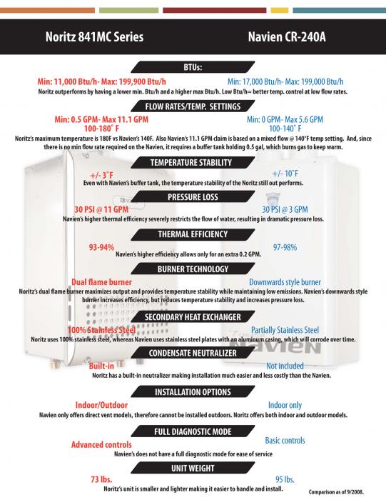

    In another thread I posted a comparison between Noritz and Rinnai, its only fair I post the Noritz Condensing unit (PVC venting) against the Navien. http://www.noritz.com/u/noritz_841mc...ien_cr240a.pdf
