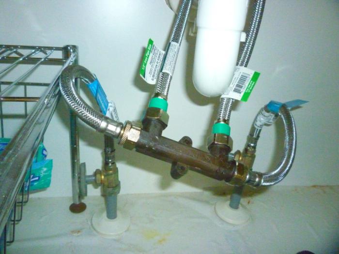

    Err... now that I look at Navien's fluff marketing, I'm concerned that my install wasn't actually complete. Can y'all tell me how I should resolve this? The quote was for external circulation.
    OK, finally figured this out. Since I do not have a dedicated recirculation line (most homes don't), they installed a Instant Hot Water Recirculating System Sensor Valve Kit. That hot water inlet (Navien fluff pic) is for the dedicated recirculation line. Since the Navien has a built-in recirculation pump, the valve kits work perfectly. So, my longest runs (master bath and kids bath) had the kits installed. Since now I know what it is, I might install another at the kitchen sink. It's the longest wait time of 15s.

    I noticed on the Watts site that they state those valve kits are not supposed to be used with tankless. That was my reading of it anyway, though I guess if it works, it works. There's something I'd like to understand about these valves and recirc systems:
    If they essentially use your cold supply line as the return recirculation line for the hot until it reaches 98* don't you now have essentially 98* water in your cold line? So don't I end up negating the "savings" by having to run the cold at the tap for ~10 seconds in order to get a nice brisk rinse after shaving?

    Unless you have a dedicated return line, you will heat up the cold line as well.

    Yea, I'm gonna have to take a picture of what they installed. It's not exactly what I found on the Watts site. I do know that it works. When I wake up in the morning to shave, that hot water is there immediately and it's the furthest run from the WH. I usually had to wait. I know that I do NOT have a dedicated recirc line.

    OK, this is what they installed on the 2 long runs. This one is in the kids bathroom. Apparently there is a thermal valve in there somewhere, which, when it gets to a certain temp, it opens/closes. Any clue?
