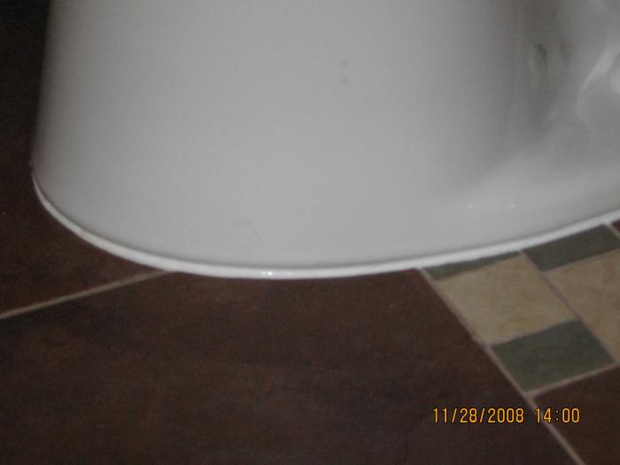

GE white silicone all the way around, using electrical tape to mask both sides of the joint, then pulled.
If it leaks, the dropped ceiling panel underneath will tell me.
