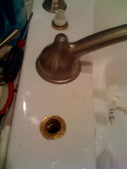

I messed up bigtime. I replaced a cartridge in my bath (moen, two handle). But it was leaking so I tried to remove it and reinstall. Only the plastic ring that holds the cartridge down got stripped, and in the process of removing it (by destroying it basically), I messed up the threads in the brass piping that the faucet attaches to. So I know I need a new faucet. But what about this brass piping? Can it be easily replaced? Is a plumber going to have to cut through the tile to access it? Please see pic. Any responses greatly appreciated.

The reason that cartridge was leaking was because you didn't have that cartridge aligned in the keyway deep down inside that brass housing.
The job I did recently was exactly the same type scenario and the tool I made out of 3/4" copper was more effective at removing the plastic keeper than the damn Moen tool I bought that's designed to remove it!
The "Moen" tool was slightly smaller and damaging the collar upon removal. I used my 3/4" copper custom built tool and wah-lah! Came right out with damaging the plastic component.
How do you know for sure you damaged the brass housing? You can't judge that by those plastic pieces alone.
There's a rim on that cartridge and you'll feel an indenture, take a flashlight and look deep into that hole where it goes and you'll see that it has to match that in order for it to mesh and provide a water tight seal.

I don't know how you would have damaged the brass part if you were removing the stem properly, but if you did, then it WILL reguire access below the deck to change that part. And because of the way the faucet is assembled underneath, it could require more work than just taking that one out and installing the new one.
