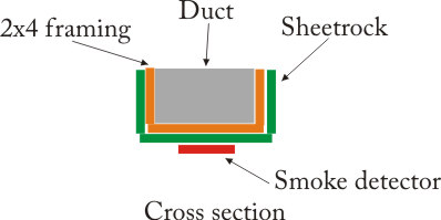

in the process of remodelling my basement, i'm upgrading the alarm system as well, primarily to increase the number of monitored zones because of added points of entry, and since they'll be out anyway, i'm looking at adding smoke/heat detectors. currently i have one smoke detector, centrally located upstairs and one heat detector in the basement laundry room. i'm adding one detector in each bedroom upstairs (not required but it seems prudent), one in the basement office (back half of the house), a heat detector in the garage and one in the basement den. the den is 13' x 24' and the ceiling is 8' high. running down the middle of room (cutting the 24' dimension in half) is a heating duct (approx 18" wide and 10" high) that sits below the bottom of the joist line. this duct has been framed and will be sheetrocked while the rest of the den will be a drop ceiling, about 2" below the joist line.
here's my question. do I need to have one smoke detector on each side of the duct or would one, centrally located, on the bottom of the heating duct chase be sufficient? if smoke were travelling up and across the duct area it would be detected right away, but if the fire started in one of corners and went straight up, it would have to fill that 10" cavity space before crossing the duct to set it off. and since i'm using a drop ceiling, if i did put on on each side, i'd have to do a veritcal mount on a wall, which means if a fire starts on an opposite walll, there would still be a necessity to fill the cavity, although not as much.

perhaps this will help.

Two smoke detectors - one on either side of the duct would be better. On the ceiling is better than lower down. (Smoke and heat rises.)
In my area, interconnected smoke detectors are required inside and outside of every bedroom.

CHeck the installation instructions. They show proper locations. In a nutshell, you need to avoid being too close to where a horizontal and vertical plane meet, because you can get a "dead zone" that smoke travels around.
two would be better than one, but both sides of the hvac chase are drop ceiling and i believe i've only ever seen wall mounted detectors when a drop ceiling is present. I'll talk to the ceiling contractor when they're out and see what they have to say about that. agreed two is better, but as I'm already incurring the cost of putting 3 in the bedrooms, this becomes an issue of prudent spending. little costs do add up.
I am aware of the deadzone when mounting vertically, but just not sure what the actual measurements are. Ideally, I'd like to mount them horizontally on a ceiling line as is traditional. i guess the $64 question is, can that be done with a drop ceiling. I've already asked my ADT guy but for as long as he's professed to be in the business he says that no one has ever asked before - I was the first, and he didn't know - go figure.

Sure, mount them to the 2x4 drop panel with holler wall anchors or toggle bolts. You now can buy smoke detectors cheap so I would use 3 in the room. One on each side in the middle and one above the drop ceiling mounted to the bottom of the floor framing. Get a fire from something above your drop in ceiling and might be a while before the smoke makes it through the ceiling to set off the ceiling alarms. Just my two cents.

i'll have to look into the drop panel. i'm assuming that in instaed of the flexible fiberglass panel, it's made of a firm material that can hold screws and anchors, but not as heavy as plywood.
the detector above in the joist space makes sense, however, the joists are 4 feet apart and run the entire width of the basement, plus there's only 2 inches between the bottom of each one and the drop ceiling, so to effectively monitor that space, i'd really need one detector for each joist bay.
