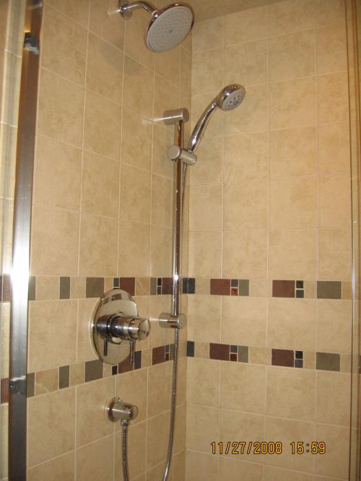

    The simplest and least expensive way to do this is with a Moentrol, the shower head of your choice, and a simple shower arm-mounted diverter control before the shower head.
    It will work just fine.
    A little more money will get you what I have, and like very, very much: A Hansgrohe Pro/thermobalance II valve and the Talis Trim kit. I also used a Grohe Wall union (where the bottom of the valve diverter sends water to the hand held shower), the Raindance shower head and a 24" Grohe shower bar, onto which the hand held is, um......held, at whatever height you prefer.
    The Hansgrohe unit has two knobs: One adjusts the temperature and the other has a handle that when turned clockwise sends the water to the shower head, and the other way it is sent to the hand held.
    Expect to spend about four hundred, give or take, on just the valve, trim kit and and wall union.
    I paid almost 1k for everything needed, and I'm very pleased with it. Here are links to the main parts.

    Default Here's a picture of the installed Hansgrohe unit, etc.
    Thought this might answer more questions with less talk............
    HE
    Thank You. Pictures do speak volume. What is a STOP on a pressure balanced valve?
