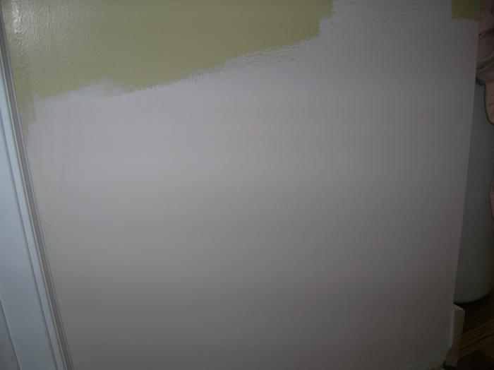

    Here is a picture of my bedroom wall that I cut open to replace some zurn pex fittings. You can see how with paper tape it will be invisible when I paint it. If I used mesh you would be able to see the joints because I would have to build them up three times as high to hide the tape.
