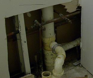

I've found some pics of the other side of the wall near this drain outlet, and the drain line to this lav seems to be a short (about 12"-16"") 1-1/2" pvc horiz run to an elbow out to the lav. I say "seems to be" because all I can see is the DWV tee and the start of the horiz run towards this lav drain.
So I was incorrect in my first post: the lav drain does not directly connect to the DWV line with a tee out. It is an elbow off a horiz run from the tee out of the DWV. Is there any way to fix this without going back to the tee and raising the tee? Even if I break into the tile behind the lav I won't be at the tee. I can't get at the tee without really messing up the wainscot'd wall outside the vanity to where the DWV stack would be.
Seems anyt upslope I do that is upstream of the tee and downstream of the p-trap would effectively create an s-trap? If that is true it comes down to minimizing the cutting damage to the vanity floor. Can I do what I asked about before: notch out the back of the vanity floor to accomodate the p-trap at the wall-out, 2-45's to get to the tailpiece? Is that a workable and would it be effective?

OK, found the picture of the other side of the lav wall I'm working on. The view here is the bathroom lav plumbing on that other side, the first bathroom that was remodeled 3 months ago. The bottom tee going out to the right is the horiz line that connects to an elbow that goes through the wall to the lav drain I'm working on. Confusing?:confused:

If you cut that horizontal run and replace with a couple of 45's in it, you could raise it.

Maybe this picture will allow you to grasp the concept of the venting on a dirty arm like that. While the picture shows a correctly vented dirty arm on the left with a sani tee, on the right using a combo or wye and street 45 creates the s-trap effect. See how the flow of air along the top of the pipe is cut off when you drop too far. Using a couple of 45's will do that.

You CANNOT use 45's ANYWHERE in the drain line before the vent connection. Your problem is that the original installer did not know how to install connections for two sinks back to back and therefore made one, the one you are working on, lower than the other side. IF he had been a good plumber the drains on both sides would be the same height and you would not have this problem. It could have been fixed when the wall was able to be opened. Now your best option is to cut a neat oval in the cabinet floor so the P trap can hang into it. OR maybe two circles with the P trap coming up from below.
