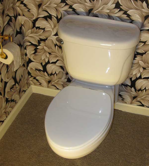

    14,214
    We installed this one yesterday.
    This uses the Flushmate tank.
    The homeowner loved how it looked.
    If you already have a wall hung installation from the sixties, this can be a good replacement.

    14,214
    American Standard.
    I'm getting 20% returns on them.
    I'm not surprised.
    Keep trying tanks and bowls until it quits leaking.
    That's how American Standard builds their products.
    In fact, that's what the tech support told you too.
    It sucks for us too.
    The nice picture of the toilet above with the floral wall paper?
    I just replaced the tank on that one too.
