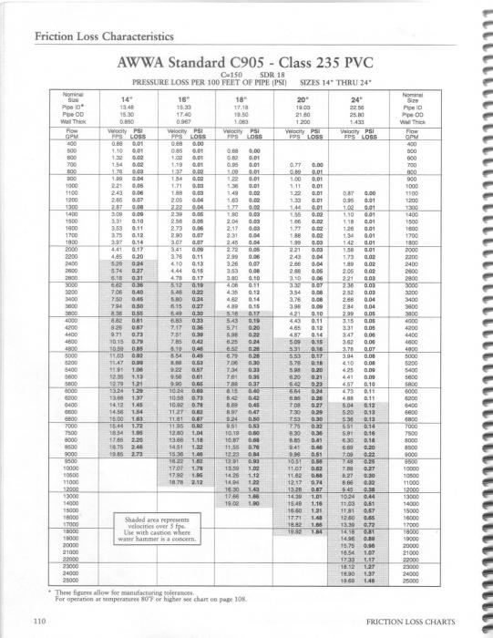

    I would not try to push more than 4,000 GPM through a 16" pipe. If the velocity is higher than 7 FPS, the pipe will come apart. I am using the friction loss chart in an old Hunter Irrigation book that I have had for many years. You can also find friction loss charts on the Internet, check with your pipe manufacturer.

    Great thinking, well cass this is my first time project too, i never had this big one, the one before only takes 4700 feet long but with steel pipe. thats why i got into lots of forum to looking for ideas or some reasonable thought, so far only MR. Valveman had a responsible answer. ok now back to valveman, broo where do you find the friction loss, do you got any address on the web? because i also had one but the biggest one only for 12" pipe. I found it at Goulds pump website. How do you calculate the FPM? this is i got to know, cause this is important matter to design a pipe system.

    Yes you can place the pressure relief after the header connecting the two pumps. It needs to be a combination valve with surge anticipation feature as well. I am looking for a friction loss chart on the web, hard to find for 16" and 20" pipe. If I can't find it, I will scan a copy from my book.

    Thanks Valveman, it is hard to find on the net, i already tried many times, but the biggest pipe i found is 12". Im really appreciated that broo. Ah one more question, according to your opinion for the pump which is the best type, a centrifugal end suction or submersible waste water pump or turbine pump. I know every type of pump has different installation on the field, im just looking at the most easy pump for maintenance. For the power im using a diesel generator set with 250KVA, for one pump only. the river only had 33 feet from the bottom. and the suction length horizontal pvc pipe 16" are 25 feet from offshore. What do you think broo???
