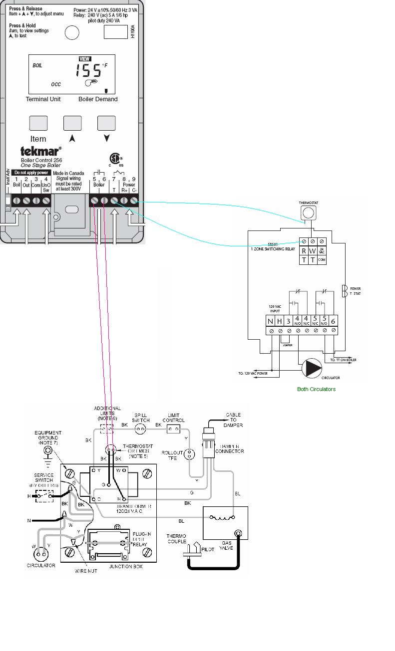

    I have:
    new WeilMClain CGa standing pilot boiler.
    two (2) 007 Taco circulators (supply & return sides)
    a Taco Single Zone Switching Relay (SR501) for 2nd circulator
    Tekmar 256 single stage boiler control
    Thermostat (boiler demand???)
    one (1) 24v transformer
    I just can't seem to get the wiring concept down. The boiler has 2 wires labled Thermostat.
    http://www.weil-mclain.com/professio...ng_diagram.pdf
    Any thoughts? Thanks.

    Oh boy. It seems to me that we've gotta go a little carefully here.
    Let's start with your proposed layout. Draw your own schematic based on your current understanding. Maybe some questions from us will help you think it through.
    How many zones do you have? (All thermostats will tie into the boiler's thermostat circuit to provide the call for heat.)
    What load will the circulator circuit handle? You may be able to run both taco's off the boiler power if it's up around 4 amps or so. Otherwise you'll need to use the relay on the crculator circuit.
    What boiler controls are in place and what are you adding? The schematic shows where the added controls should be in the circuit so all you need to do is identify the additions and the appropriate wires.
    You'll have to supply power to the boiler and circulator relay (if used).
    Draw your schematic with notes on wire colors and identify control or function. Reference your wires to the manufacture's schematic so function and location are clear to you. Write your questions right on the schematic.
    Take your time and think it through based on function.

    I've gotta say oops. I just looked up the Tekmar 256 and it's an outdoor reset. I can't help much with that. What I do see is the Tekmar boiler taps will tie to the thermostat circuit on the boiler. You'll need to supply 24 VAC to the Tekmar, maybe that can be tapped from the R and C terminals on the boiler. Make sure you aren't overloading that transformer.
    I suspect you won't be able to run the circulators from the boiler power circuit, e.g. the relay will be required. That relay will have to be on the circuit with the thermostat so the circulators will run regardless of whether the boiler sees a call for heat or not. The result will be along the lines of: the wall thermostat will make a call for heat which results in the circulators starting and the Tekmar sensing the call for heat. The Tekmar will check the water temperature and decide if the boiler needs to see the call for heat. The Tekmar will make calls for heat to the boiler as needed to maintain the water temperature that it desires.
    Like I said. Draw your schematic and post it. Label all taps and note function. Expect corrections, it's no big deal if it takes two or three trys to figure it out.

    Ok, now we've got something to work with. It looks like you've diagrammed things clearly.
    With the proposed diagram water won't circulate until the Tekmar calls for heat. The Tekmar call for heat depends on the thermostat calling for heat and a water temperature below the Tekmar's target. In other words the circulator and boiler will shut down when the water reaches the Tekmar set point even though the thermostat is still calling for heat.
    I think that you want water to circulate any time a thermostat calls for heat. That means that the relay has to go in the thermostat circuit.
    The Tekmar control will tell the boiler when to add heat to the system (maintain water temperature) so the Tekmar has to control the boiler. The boiler shouldn't be connected to the relay.
    That's my $0.02.

    OK, so i have both circulators on the single relay with the TT wires on the relay goin got boiler. I'm still lost as to where/how to wire in the Tekmar 256?
    see: http://www.xjmllc.com/images/im4510_20071018_145844.pdf

    Here's my suggestion for wiring from thermostat to relay to tekmar to boiler. I've ignored the other sensors on the tekmar.

    I realize this is an older thread, but there was never any real resolution given, so for the benefit of future readers...
    Room thermostat wires to the thermostat terminals on the SR501.
    The T T terminals on the SR501 wire to 7 and 9 on the Tek256.
    The 5 and 6 terminals on the 256 wire to the G and R on the boiler.
    In this way, the circulators run on a heat call, the TT signal tells the 256 that there is a boiler demand, the 256 evaluates the water temp in the boiler and the outdoor temp and determines whether it's appropriate to fire the boiler.
