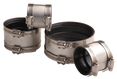

    Who do you call to ask if something is allowed or code legal in your area? Can you just call a plumbing business and ask or do they not like that? Just don't know who your supposed to call to ask a question like that? I want to call and find out if I can use transition cement for ABS to pvc or do I need to use no hub couplings. Thx.

    You local building department will have information on plumbing codes.
    You will be able to buy a permit and talk to the local plumbing inspector.
    They can be very helpful.
    It's what we do.
    When I was plumbing meat markets around Puget Sound, it was the first call I made. Sure I had approved plans, but it was important to talk to each inspector in each city to find out what he expected. I think I plumbed eight of them for the same grocery store, and all eight were plumbed a little different.
    You will need to use shielded couplings to transition between ABS and PVC

    Sorry, I thought I had my location listed. It actually said Virginia when I looked up just now. LOL, I am in Southeastern, Ohio. I actually already have the couplings and transition cement. I guess I will try to call tomorrow. I just assembled and glued my waste/overflow and would like to get the rest of the plumbing glued tomorrow. Hard to get a whole lot done between work/babysitting while the wife works. Good thing we got 2 baths lol. Thx guys. Hopefully there open tomorrow. I just didn't know if it was inappropriate to call and ask questions or what. Have a good one.

    I actually already have the couplings and transition cement. .
    There's your first problem. Most codes will not allow joining of dis-similar plastics with transition cement. Mechanical couplers must be used.
