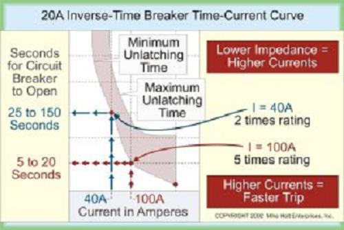

A resi single pole 15A breaker trips occasionally when powering up a 120v chop saw. The HO wants to test the breaker, since this is the second saw that has done this.
1. Somehow find out what breaker make and model you have, e.g. SQ-D QO-115.
2. Find the trip curve from the manu's website.
3. Read that twice the rated current, 30A, will trip this SQ-D breaker in 8 to 27 seconds.
4. Put enough hair dryers, toaster ovens and incand. lamps on this circuit so the total is 30A.
5. If the (SQ-D) breaker trips in less than 8 seconds or more than 27 seconds, it's bad.

One thing to remember is a saw is powered from a motor. A motor is nothing more than a coil of wire.
Coils of wire hate to have a change in current flow. When the coil has no current flowing it will try to keep current from flowing. When a coil has current flowing it will try to keep the current flowing.
A quick look at the Tables found in 430 of the NEC one can see that the locked rotor amperage is six times that of the full load amps.
In other words a 5hp 230 single phase motor has a FLA of 28 amps, Table 430.248 but that same motor has locked rotor amps of 168 amps Table 430.251(A).
When the motor is sitting still it has a locked rotor. This motor will draw 168 amps in order to start the rotor moving. This current does not die down quickly but takes a couple of seconds.
Here in lies the problem with the table saw. Install one size larger circuit and the problem is solved.

This was someones else's problem, but,
for my saw the DC resistance was 1.8Ω and with the Romex connecting cable the load on the breaker may have come to 2Ω.
120v/2Ω = 60A rms for at least a half-cycle, dying down to way less than the rated 15A or less, in a second or two.
Bless your little heart but it is not as simple as the voltage divided by the resistance of the motor.
The motor is a mass of windings of copper wire coils and has an inductive reactance to current flow.
If you were using the resistance of the motor then the 60 amps you would be drawing would be a constant draw not a momentary draw.
Simply by looking at the Tables in 430 I can find the full load amperage of any horse power motor.
Let’s say that the saw has a ½ hp motor. That would be an amperage draw of 9.8 amps. 120 divided by 9.8 equals 12.24 ohms which is a difference of 10.24 ohms.
If the blade is locked down so the motor can’t turn then the motor will draw 58.8 amps. On a 120 volt circuit the resistance of the motor will drop to around 2 ohms.
To just ohm out a motor does not give you anything other than the resistance of the motor windings.
This seems to be possible with a 15A breaker, with the right trip curve. And, the saw manufacturer is motivated to make his saw work with most run-of-the-mill 15A breakers. They also want to squeeze the max. performance out of these 15A.
This is not the trip curve of the breaker. Attached is the trip curve of a twenty amp breaker courtesy of Mike Holt
That's what I'm getting at. If the breaker is tested, the HO can say this breaker is/is not meeting factory specs, and make troubleshooting decisions based on that.
It's easier to check a trip curve than puzzle over the starting transient current draw for a saw.
Just MHO.:)
It would be my guess and I must admit that I know nothing about the saw or the circuit but the problem is more than likely to be found in the saw. It could be that the saw is too big for the circuit it is on or the saw could be worked to hard. The list goes on and on.
That Holt guy has done quite well for himself, and his family, I must say. I think he's a consultant for EC & M magazine, in addition to his books, tapes, videos, etc.
Georg {not "George"} Simon Ohm, as well as Léon Charles Thévenin, would disagree with some of what you said!:D
With your graph I have a generic test for 20A breakers, by loading them to 2x rated. It just takes more hair dryers, toaster ovens, etc.
