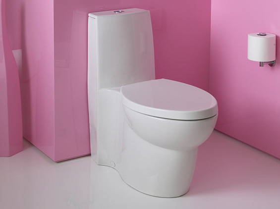

    Hi,
    I'm familiar with the Toto Aquia I (800 MaP and harder install) and the Aquia II (500 MaP and easier install) ....
    Does anyone know how the Kohler Saile Toilet Stacks up? Its a one piece design versus the Toto two-piece design so it looks a little more sleek. Its also rated by the SFPUC as 500 MaP and its also a dual-flush design.
    Kohler K-3564 Saile
    http://www.us.kohler.com/onlinecatal...&prod_num=3564
    http://www.us.kohler.com/onlinecatal...id=172_newprod
    Strict 12" rough-in (1/8" wall gap)
    List price*: $667.45 and up
    28-1/2" L x 14-1/4" W x 28-3/4" H
    Dual Flush flushing technology
    0.8 or 1.6 gallon water consumption options
    Compact elongated bowl

    On the Kohler, make sure you have at least 12" on your roughin, and that you can cut your floor molding where the bowl fits against the wall.
    On the Aquia, you have a bit a space behind the tank, and you don't have to cut away the floor mold.
