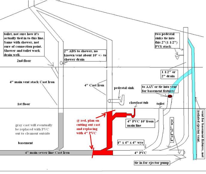

    Here it goes....I have a 1915 Bungalow and I am in the process of a complete remodel of the bath on the 1st floor. The old layout was horrible and there was no real vent for the tub or the sink. The toilet was tied directly into a 4" Cast Iron wye off the 2nd floors drain/vent. The only problem I had was the sink was sometimes slow to drain, but the pipes were badly corroded. The tub/shower drained fine.
    Questions:
    See diagram in below post #16 below. Is this ok?
    Last edited by Master Brian; 11-14-2008 at 08:10 PM. Reason: Picture and some text incorrect.

    Where to start. Not one single thing in that diagram will meet code. Other than the ejector pump not one single vent is proper. You really need to get a licensed plumber to come out and take care of this.

    Quote Originally Posted by nhmaster View Post
    Not suprising, it has issues, but without gutting this house, the options are somewhat limited. This has been worked on several times over the years by professionals, from what I've been told and from looks, and you are still saying not one single thing will meet code except ejector pump, which I installed. I have been told the upstairs bath was done/remodeled in the late 80's and I found newspaper filling a hole in the plaster in the 1st floor bath from 1991, which leads me to believe that was when it was remodeled last.
    I actually did have a licensed plumber come out for the 1st floor bath and he didn't offer any solution for venting the toilet. He recommended the AAV for the sink and again mentioned nothing about the tub vent. I think he thought all were close enough to the stack that feeds the 2nd floor toilet and shower. I didn't/haven't gone with him, because I think for no more than what he brought to the table, he was a bit pricy, considering I had thought of all of that on my own and could easily do the work for about 1/8 of the price. The only thing he did suggest was that I had the sewage ejector pump inspected.
    Not to be argumentative about this, as I'm sure most would say call someone else. Long story short, that doesn't seem to work for me. People don't seem to want to work around here. I guess the economy isn't too bad afterall!!!
    In any case, the 2nd floor seems to work fine, so for now let's totally disregard any issues that has with itself. I may come back to that as I plan on doing a remodel up there in the future. I only listed that stuff in case it has a negative issue on the plumbing below.

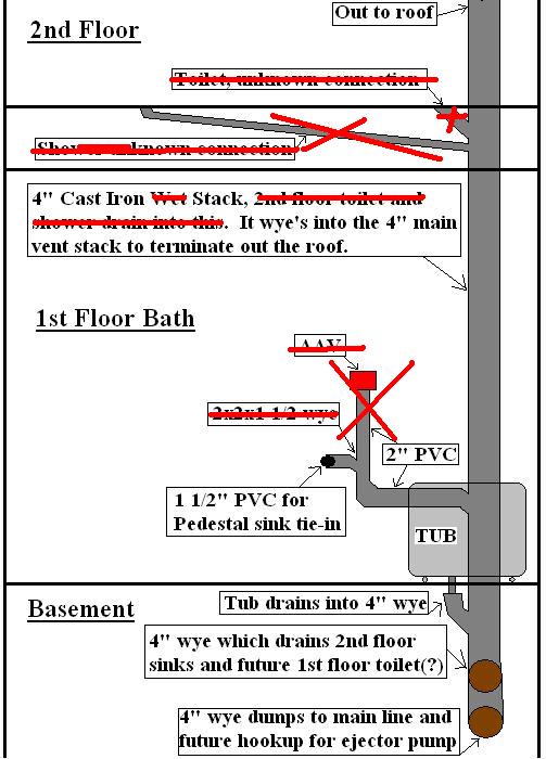

    Ok, I have included another diagram. This time of the wall where the sink and tub will be installed. I am hoping to break this down a bit.
    I did again include the 2nd floor fixtures in the diagram to show what drains where. I am hoping this is more clear. What problems are there with this?
    ANY??
    Again, the toilet and shower on the 2nd floor drain fine. I am guessing the 2nd floor toilet is vented ok, because it is most likely wye'd directly to the stack and the stack vents to the roof. The 2nd floor shower, I am pretty certain, does NOT contain a proper vent, but during a remodel in the future I will/can add one. My concern with these is that they don't over tax the line causing the traps of the 1st floor tub and sink to be sucked dry.

    The second floor toilet is vented, and the shower would also be if it were not 10' away from the connection. The lower fixtures are not vented and an AAV would not work, because you will have as much, or more, problems with positive pressure as negative, and an AAV is useless for positive pressure. I have no idea why you would have a 4" cast iron "main vent" line with no plumbing connected to it. That is something we would only find in multistory commercial buildings, and even then it would have a purpose.

    I don't know what to say here. Truth is most of it should be torn out and done over. There is no quick fix here and I suppose you might as well do whatever you think will work. But none of it will pass an inspection.

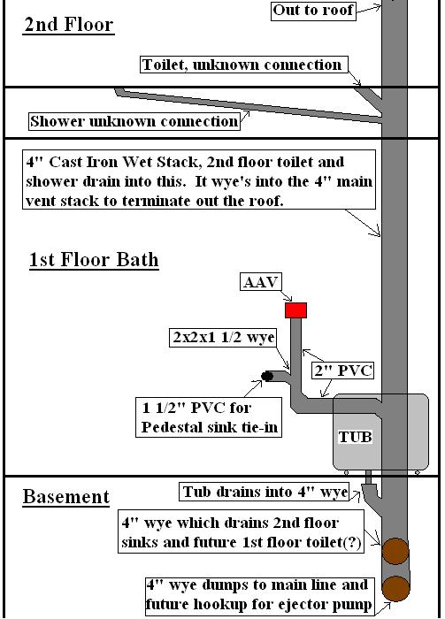

    If it drains would you mess with it in the future or leave alone?
    What problems do positive pressure cause? Lack of water in the trap? One thought was using the AAV, but instead of tieing into the 4" vertical cast iron run, that I would drop through the floor and tie in fresh to the horizontal 4" cast iron run that exits the house. Would the AAV work fine then?

    What about this diagram? IF the 2nd floor uses the other 4" stack. I would then assume I should get rid of the AAV for the sink. Could I use it for the toilet perhaps and still drain the toilet into this stack? The only problem I face with that is the wall behind where the toilet is going is only 1 1/2" thick, so no room to tuck it in there, I'd have to find a way to go into adjoing cabinet or closet.

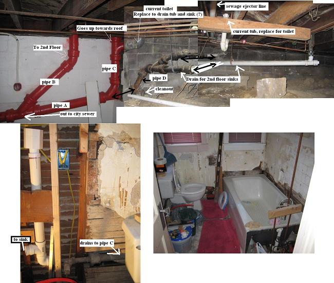

    Here are the pictures I took. I tried to tie them together to make a somewhat panoramic view, hope it makes sense.
    If my previous post didn't make sense, I'll try again. Going off the theory that pipe B drains the 2nd floor fixtures, minus the sinks and that pipe C is only draining the 1st floor fixtures.
    My thought now is extend Pipe A with 4" PVC. to go about 4-6' into the 2nd part of the upper half of the picture. Then I can cleanly and seperately tie my sewage ejector pump, my 1st floor toilet and my 2nd floor sinks into Pipe A. Each item will tie into pipe A with the appropriate sized wye, individually and install a new cleanout at the end of this run. That way they don't interfere with the drainage of pipe C. I'll tie new plumbing for 1st floor sink into cast iron pipe that is just visible behind the toilet in the bottom right picture and let it drain into pipe C. Only about a 2' run, so I should be fine on the venting, correct???
    I am going to be placing the clawfoot tub along the wall with the 2 windows and the drain will be about where the toilet is currently sitting. The toilet will then be placed where the drain for the tub is. I just have to figure out it's venting.
    How does all of this sound? I'll be looking in the attic within the hour to see if I can make sense of what feeds pipe B & C.

    Ok, I was originally incorrect about the 2nd floor fixtures draining into the 1st floors. I checked in the attic and sure enough Pipe B above drains the 2nd floor toilet and shower. Pipe C handles the 1st floor fixtures. Am I now better off?
    The new toilet placement is still in question as far as where/how to place the vent. Any suggestions.

    You are a lot better off!

    Dec 2007
    7,460
    Well can you redo your drawing to show how things are done now and what you plan on changing.
    A simple drawing is fine.

    According to your new description, yes, but then your first description was inaccurate also. The pedestal lav still needs a vent and according to your new data, it would be better to connect the vent properly than to use an AAV. The upstairs tub may have worked for umpteen years, but that does not mean it has been working properly.
