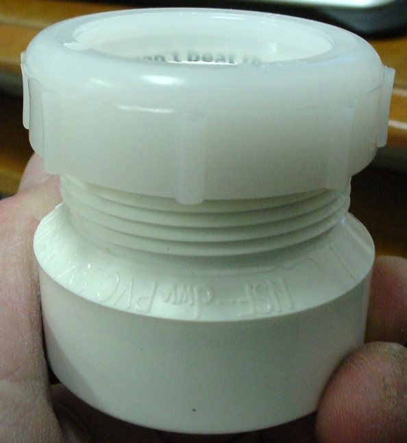

    I just got back to this thread , and i think i know the trap adapter you mean.
    (see pic below)
    That is designed to adapt from a 1 1/2" PVC trap up to the smaller diameter 1 1/2" Polypropylene drain/overflows.
    Hopefully you have a 1 1/2" PVC trap. In that case you won't need an adapter- you can just glue everything together- If this is not in an accesable area you definately do not want a slip joint (as with the adapter).
    The best thing would be to replace the trap if it is not PVC.
    Then the question becomes: What is the next pipe type changover from the trap? (into a main drain line or different type pipe such as old galvanized, etc.)

    Yes you are correct. I am just going to go with a PVC tailpiece and glue now. I have a PVC trap. BUT, I just found out I have to get a different one. The trap I have has a union. I guess I can't use it, have to get a solvent welded trap also. I thank you for your input.
