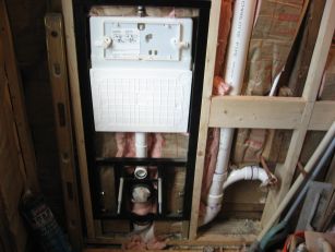

    Can let you know. I am installing one in the job we are working on now and have the info on the job site. This unit has a metal frame that mounts into the stud bay, (2x6 wall). I just reframed the wall with 2x6's so to get the 19 1/2" that the unit fits into. Seems like the bowl will rest up against the frame members with the sheet rock in between it of coarse. But still thinking about putting up 1/2" ply on the wall first then sheet rock over that. Will check the info at work though.

    Actually the model shown above mounted to the 2x6 wall is almost identical to the model we picked out.. . The customer is aware and chose the wall mount simply because its on of the only ways to make it work in this situation.
    Its a carrier almost exactly as above and its a duravit toilet, the carrier is by Gerbit.
    I definately can make the carrier sturdy in the wall with the space and 2x6 studs we are mounting, but my worry is the wall board itself. If i place the sheetrock up (thinking green gypsum) im worried the toilet will just cause cracks in the sheetrock/paint.
    Im trying to find away around this. I was thinking of doing 1/2 plywood, but then plywood in order to be mounted would stick out beyond the toilet sides and obviously wouldnt look very nice.

    To clarify my concern.. when i tighten the bowl against the carrier im thinking the sheetrock will smush... I dont see how i can get it tight without damaging the sheetrock.

    On a carrier system, the attachment is beyond the wall.
    The toilet never touches the wall.
    NOTE: Bearing nuts and washers must be set
    to take full loading from the fixture allowing
    1/16" clearance between fixture and wall.
    http://www.terrylove.com/pdf/glenwall_install.pdf
    You will have threaded rod, a nut, and then a larger washer.
    The bowl sets up against the washer, then you secure the bowl with another set of nuts.

    The toilet does not touch the wall when properly mounted. It mounts against backing nuts and washers which place it 1/16" or 1/8"outside the wall.

    It won't damage the drywall. This has been done hundreds or thousands of times before. Call Chicago Faucet / Geberit and ask them. Call Duravit.
