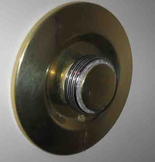

My shower has a control valve that rotates clockwise for temperature control but has no control for water flow. I would like to change it so I can control both. It has no identifying brand marks or emblems so I don't know what it is. I assume the center disk must snap out but due to the corrosion I have not been able to remove it. (didn't want to break it)
So does any one recognize this handle and how do I go about replacing it?

The handle looks like an old Price Pfister, but they pulled out for volume control. Their button unscrewed, but many others just snap out. To do what you want, the entire valve will have to be replaced, not just the part the handle is attached to.

Must be me....I don't see a handle, just an escutcheon with the guts removed. How about a pic of the handle and the cartridge.
In any event, the answer to your question is >no way!
Shower valves these days are required to be anti-scald. Most (but not all) that use pressure balance valves have NO volume control, it is either full on, or full off. Most thermostatically controlled valves (and some PB ones) have both a volume control and a separate temperature control. As noted, you'll have to change the whole thing to get what you want unless you can live with a new hole in the wall and run the current output through a new volume control valve.

That only controls the maximum temperature. The codes address the problem of sudden pressure deviations which change the temperature, usually hotter, instantaneously. The only way to do that is to either balance the pressures so they do not fluctuate, or use a thermostatic valve which does not rely on a fixed balance between hot and cold volumes for a given temperature.
If it's set at a nice say 105 degrees, your hot supply is a nice toasty 130, and the cold is turned off, guess what temp you are going to get out of that supposedly temperature limited valve...as much as 130-degrees. This can happen if someone in the bathroom flushes the toilet, disrupting the relative flow volumes between the two supplies. It probably won't last long, but the objective is to prevent that possibility. A pressure balanced valve will reduce both outputs or turn off the necessary output depending on the relative imbalance to protect the user. Children and older folks both have much thinner skin and burns can result; the startle effect can also cause them to slip and fall.
