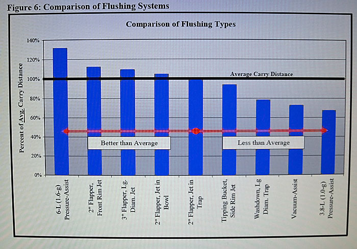

Any American bowl with a 3" flush valve is going to kick Caroma's butt when it comes to drain line carry.
At least if you go by testing for toilets done by independants.
1.6 gallon, Washdown Large Diameter trap (Caroma), 79% of average carry distance
1.6 gallon, 3" Flapper siphon jet, 108% of average carry distance
1.6 gallon Pressure assist, 132% of average carry distance
I sell 3,000 toilets a year, very few of the Aussi dual flush.
There are plenty of better products out there.
Whoa! That is surprising for me.... I'll keep that in mind when Buying a new toilet.
