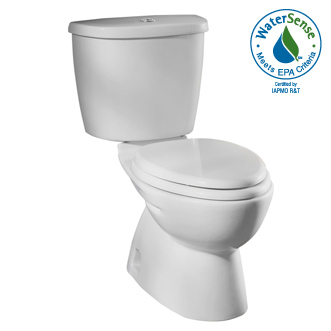

Hi there,
I recently bought a Flowise #2479.216 and I'm just not sure about if it is ok or not.
Here are my questions:
- Is it normal that at the end of the flush cycle there is no "air sucking action" (in other words: the water doesn't completely go)?
- Is it normal that there is only water in the little lower part of the bowl, where the drain starts (about 3 inches wide by 4 inches long BY 1 1/2 inches deep? I know that it is suppose to retain less water in the bowl but that little, I doubt it!
- When we use the toilet for liquid waste, is it normal that some of it remains (the water after the little flush doesn't become perfectly witty clear)? Because of that un-proven performances , we didn't have the courage to test the solid waste. Is it safe to use it normally with solid waste?
- By the way, according to the poor manual, I think that the water level in the tank is ok, if I compare my tank and the schema.
- What is the popular appreciation of that model?
- Is it possible to return a toilet to the store or American standard directly if we are not satisfied? (Well, before being satisfied or not, I need your advice on this model).
Thanks a lot guys,
- Eric Thibeault

Being a gravity dual flush, you will have the small water spot in the bowl.
I would consider that normal for a dual flush like that.
The Toto Aquia dual flush and the Caroma dual flush have the small water spot too.
It's also a washdown bowl, so it may be that some of the water does not leave the bowl on the small flush.
Hard to say without seeing it.
Can you post a few pictures here for us to see?
I'm sure it is.

Hello guys,
Here a photo of my toilet to check with you if the water level is normal.
I can also tell you that it took 2 full flush to get rid of the solid waste. I assume that it is not normal and I want to know what can be done about that. We have the toilet since a month.
Thanks,
- Eric

Yes that is normal any more water in the bowl and the lower flush would not be able to clear the water.
33,603
1,042
bowl
Slowly pour water into the toilet to see if the water level rises, and if so how far. Unless it is completely full to its design level before flushing, it will not flush properly.

I poored about 6 liters of water slowly in the bowl but the level didn't rise. Is it normal?
TIBO
Quebec
Hello Terry,
For my own curiosity, can you give me a brief explanation why on this toilet, the water level is always the same, even if I poor a big amount of water in it?
I'm - as you could see - not a plumber and I this concept doesn't make sense to me. ;)
Thank you
The water in the bowl can only be as high as the top bend of the trapway.
That acts as a dam for the water, add more water and it just goes over the dam.

You my Friend have American Standard's Attempt at Washdown Flush Technology.
Washdown is Different from Siphonic in that Washdown pushes the waste out of the bowl unlike what you are used to where the toilet would pull the waste out.
The Low water level is normal because that is how much water the toilet was designed to hold in the bowl since it is a Washdown Toilet.
You toilet is not broken if it doesn't make the air bubbly sound because the water is being pushed out.
