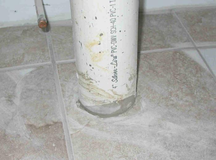

I've attached a picture of what I'm up against. I've never set a toilet, so that tells you my experience level. However, I have had success with other plumbing tasks associated with finishing a basement. In other words, I like learning.
I've done some research on how to go about setting to the drain in the picture... I believe I want a inside flange, a diamond drill bit for the tile, and attach it using tapcon screws to the concrete slab. I want the top of the flange to set 1/4 inch above the tile. Is this right?
I question using tapcon to anchor--is it enough? I plant to cut the 4" flush with the tile with a dremel cutting wheel. I will then anchor the flange. If the tile is 1/4", the thinset is 1/4", how deep should the anchor go into the concrete? What do most inexperienced people screw up when attempting this?
