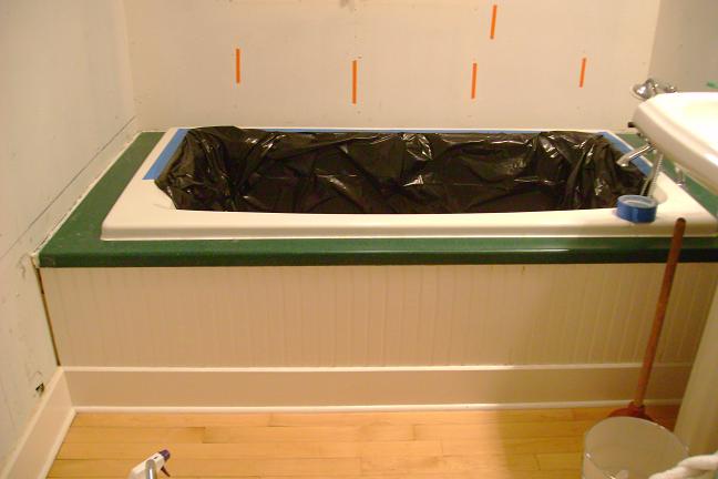

    I have taken on another project that I have questions about, this one is a bathroom. I can't seem to upload a picture but the tub is a jaccuzi style without the jets or holes. It sits on a green rectangular lip of counter top material that butts up to three walls of an alcove. The average horizontal distance from the tub perimeter to a wall is 3". The height from green lip to the uppermost part of the tub perimeters top surface is about 1.5". The appearance is that of a channel running around three sides if the tub-no good if a shower is going in there. I built this myself for only tub use but now have to change it to deal with shower spray. We want to tile the walls and tub surround. My options seem to be:
    1) Build up the green lip horizontally so that the tiling would come flush with tubs top surface. Would the ensuing water puddling from showers be a problem? How should I build the surfaces to minimize potential water leakage (overlap sequence) and I assume there should be silicone caulk between the dissimilar tile and fiberglass tub materials to allow movement. The lip is robust and I would use 3/4" plywood under Hardyboard with a plastic liner somewhere in the mix but I don't quite know where.
    2) The above but with the build-up surface sloped toward the tub to permit some water shedding. I think this would not look very attractive and probably harder to do.
    3) Build a vertical false wall up to the tub edge and tile directly onto that. The tile would make a right angle with the tub upper surface. This would generate a shelf up where the tile stops at the top.
    This was a bit long but I wanted to get all the issues out at once. There is also a window which the tile would have to go around but that only gets a bit scary with option 3. If anyone has some ideas or experience with this I would much appreciate some wisdom thrown my way.
    Thanks.

    Those tubs are not really designed for a shower installation, but if you insist the only proper way is to build the deck up to a point level with the tub rim with a slight slope towards the tub. Then tile over the rim of the tub using a bullnose, or corner, tile to give a finished edge to it.

    I'd build the walls out so that you could tile new ones so they overlap onto the flange. www.schluter.com has a trim piece that you could use as an expansion joint that would not require any visible caulking - Dilex. The manufacturer of the tub may sell, or there are some generic versions of a glue-on tiling flange for this type of tub. You could use Kerdi on the walls and use Kerdifix (a urethane adhesive sold by Schluter for their stuff) to adhere it to the tub surface which should prevent moisture from getting into the walls. Kerdi is a surface applied water-proof membrane that you can tile to. The combination should keep things watertight. Kerdi goes up sort of like wallpaper, except you overlap the seams and you use thinset rather than wallpaper paste to apply it to the wall.

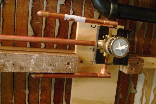

    Left is before the big work, right is the balance valve with hammer absorbers roughed in.

    While you've got the wall open, why not put in real hammer arrestors? Those will quickly fill up with water and the only way to clear them is shut th ewater off and hope.

    To Jad... are these not real? Were you referring to the larger version? And don't they all fill at some point?
    And to HJ... Bypass plug? Per the wifes wishes, and I don't see why it shouldn't work, the H/C pipes from the basement branch just after shutoffs, one set (shown) go to the mixer the other to the previous tub filler hardware;valves and faucet. My complaint was that the mixer is out of the tub pathway and may allow the dreaded scald if a toilet is flushed. I was out-voted. But even this set up has all the necessary components to work it seems to me.

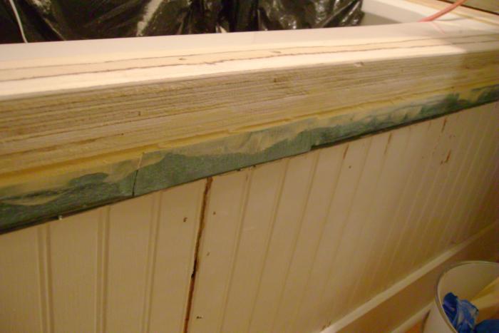

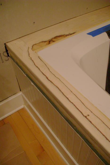

    I ended up deciding to level-up the deck to the tub with glued layers of plywood. It is rock-solid that way and will only need the thin-set/membrane/thin-set/tile to finish it off.

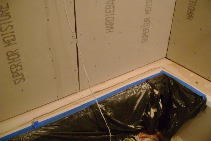

    Slowly but surely. Decided on Schluter-Kerdi product to proceed. HardiBacker is up over insulated walls and plumbing is mostly done. Found a neat device to plug supply pipes during pressure/leak testing. Just pushes on like a cap but can be removed with plastic collar and pipe end is suitable for sweating. Came in handy as I could not complete deck faucet install until tiles in which would come last and space was tight. So I just lined everything up for later, capped the pipes, checked for leaks, and will finish the faucet when the tiling is done.
    Pictures of HardiBacker and plywood filler around tub on top of old, now sanded, green deck with top beveled to shed water into tub.
