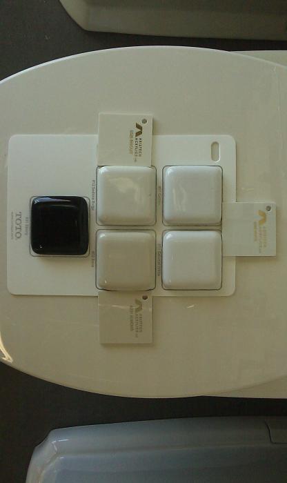

    Oh the fun of the color game. Usually I end up telling customers to tell me what they are trying to match and I will bring in their version of that color.
    Here is tub acrylic samples compared to the Toto virtuous china samples:
    Rob
