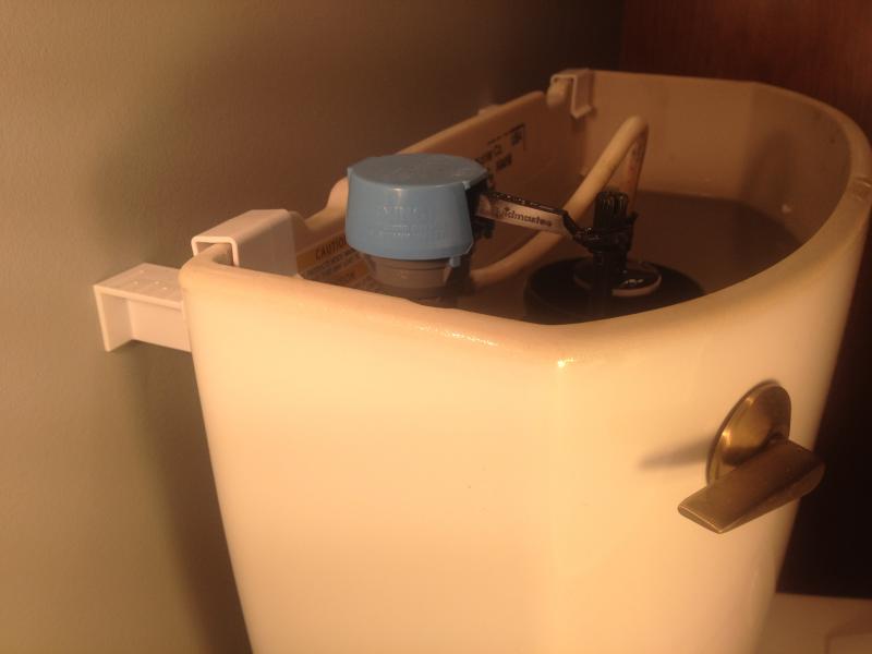

    This is still a 12" rough in toilet. The manufacturers make the toilets universal these days. So a real 12" rough in will have a 1.5"-2" gap from the tank to the wall if the flange is a true 12" from the wall. We use a product to stabilize the toilet tank and by filling the wall gap. It's called a toilet tank stabilizer by tank truss.
    Name:  2012-09-12 10.47.34.jpg

    The tank truss mentioned in the previous post is certainly interesting and you won't hurt anything by using them. However, a tank that is attached following the detailed instructions included with every two piece Toto will not wobble or need the extra stabilization. The key is to gradually snug the tank down alternating from bolt to bolt to bring the three points of contact together equally. Some find using a playing card or business card as a feeler gauge to be helpful. When the card begins to resist removal, that's enough. Just don't let one side get way ahead to the other. For those folks who like to lean back against the tank, the stabilizers may be a good addition, but for the rest of us, not really needed.
