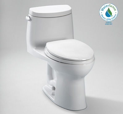

    Here's a picture of the Toto 2-piece Gwyneth. Definitely less expensive than the one-piece. It has the "sanitary dam", which makes it hard for anything to disappear into a crack between the pieces, so I don't think there is much of an advantage of the 1-piece, unless you just like the look better.
    Two piece Gwyneth with softclose seat, $399.99
    One piece Gwyneth with softclose seat, $474.99

    According to the latest MaP report, the one-piece Gwyneth flushes 500 grams while the two-piece version flushes 800 grams, I presume because of the higher head pressure in the two-piece.
    14,191
    That's normally it.
    I have the one-piece Gwyneth upstairs.
    It seems to work fine.
    Ben from the Northwest distributor put three in his home.
    Anything 500 or more seems to work fine.
    I mean, how much paper are you using?
