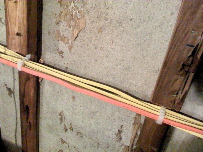

2.
In the attached picture I'm running 6x 12-2 and 1x 10x2 in a basement wall. Does this look OK? I've stacked the wires in the plastic spacers every 16 inches. I've heard that when wires are bundled together they can get "derated", but I've also read it only happens when they are bundled together directly for more than 24" at a time.
Many of these lines are feeding an unfinished inlaw suite consisting of a small kitchen and bathroom.
In case you need to know, the 12-2 lines are for:
Garbage Disposal
Microwave
Small Fridge and Oven Fan
Small Appliance circuit.
Bathroom (fan, light, receptacles including up-flush toilet)
120Volt washer/gas dryer
the 10x2 is for when I eventually add Central Air.
Thanks again...
