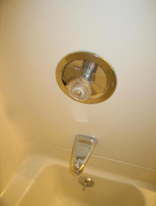

    Hey guys,

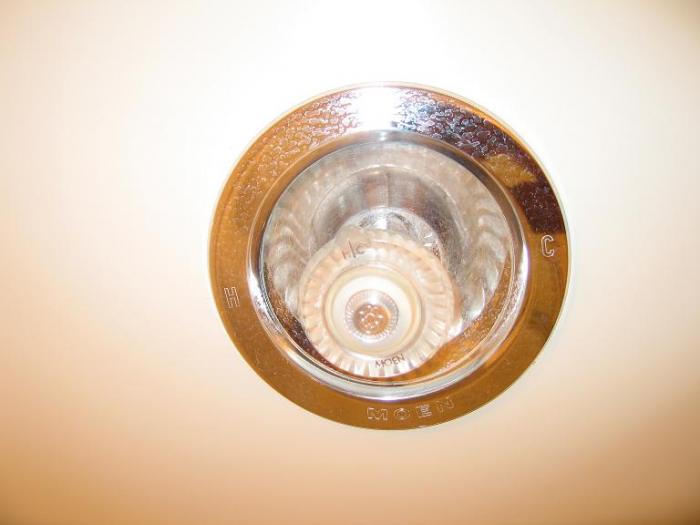

    I would like to replace my shower/tub handle. It's a standard single Moen handle, it pulls to turn on the water, left/right -- hot/cold and pull stem on the spout to turn on the shower. I would like a lever handle if possible. What are my options? I've attached pics.

    You do not have a lot of options, but there may be some. Moen used to have a lever handle option available for that Legend series valve. I don't know if they still make it., but an aftermarket company may. Take your handle and escutcheon plate into a large pluming store ( NOT a home store). They should be able to help.

    Go to this link and plug in the info in the pull down menus to see what trim parts are available there are...
    There are 9 with levers and 10 with knobs for you to select from.
    Click here for Moen replacement parts.
    The problem peanut mentions is a possibility with the levers and a new (loose) cartridge.

    I went there earlier but what's not clear to me is do those kits at that link require that I replace the cartridge or any of the plumbing?
    Dec 2007
    7,460
    No the basic valve is the same.
    You just need to find your valve and the associated part numbers for the trim and knob then compare to what you want to have and install the differing parts.

    Moen has many different trim kits available, but you have to choose from the Chateau or Moentrol line.
    9,003
    The devil is in the details. I think your Legend has the escutcheon screws at 5 and 7 oclock. I dont think they have any trim for that. The Legend Moentrol has screws at 2 and 7.
    All the valves on the website labeled as "PosiTemp" : NONE of those parts will fit your valve at all.

    Moen does make a trim kit for the standard valve. it is a Monticello style model T2529 (tub/shower) or T2524 (shower only). This is a direct trim kit that will attach to the wall, providing the screws are definitely at 5 & 7. Legend as far as i know, does have them.
    This is the spec sheet for the above trim kit.
