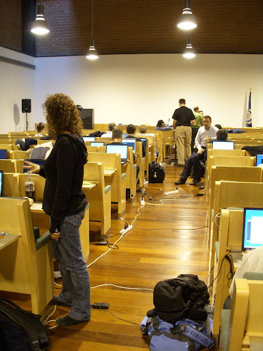

    I would think that the job of a Nationally Recognized Testing Laboratory would go a little future than checking to see if something caught on fire.
    One of the labs for UL is located in Research Triangle Park in Raleigh, North Carolina just a little over an hour from where I live. I get to talk with some of the persons that work with UL on a regular basis, see the Education Committee and look for my name as well as Mark Ode. Once you see that we sit this committee together then Google search Mark Ode or just click here Mark is one hell of a nice guy and will bend over backwards to help anyone he can.
    The one thing that no NRTL can do is idiot proof anything that they test. A power strip will be tested at it rated amperage and voltage. Should someone buy one and load it in excess of its rating it will surly be damaged. Should someone buy a power strip and abuse it by throwing it in the floor and letting anything and every thing fall into it surly it will fail. Any of these would not be the fault of the NTRL but the fault of the end user.
    I am sure that the power strips was never tested as they are being used below;
