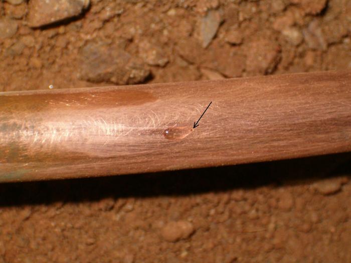

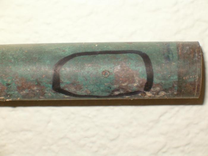

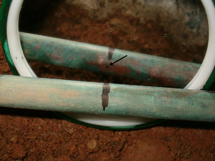

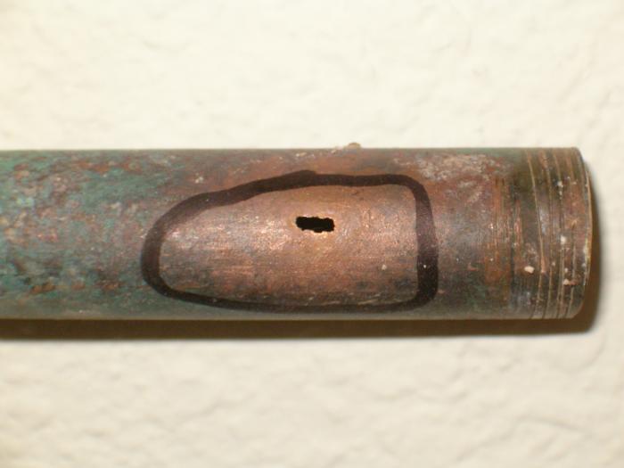

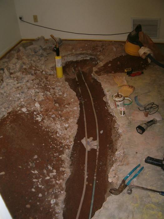

Here are some photos of a house, where the copper pipe under the slab was leaking. The first repair was about 12 years after the house was built, and then I did another repair about 15 years after the house was built.

Interesting. I have NEVER had a house in Phoenix that had that problem. And only a couple of under slab leaks that could not be attributed to poor workmanship during the original installation.
Yep, before I did the repair and pour back at his house, I begged the home owner to call a licensed company to do a complete re-plumbing on his house. He told me that if I don’t want to do the repair, that he would get someone else to do it. So I did the repair, and the pour back, and needless to say about 3 months later, he did get a complete re-plumb job.
His house is located on the North side of Camelback mountain, (if you know the area of Phoenix). And remember, this house was around 15 years old.
Thanks, Mike
