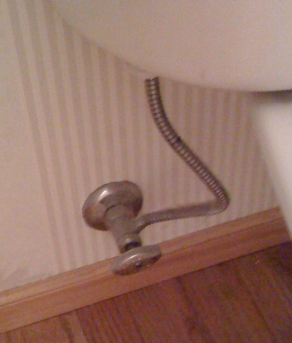

I need some help. Our house is about 10 years old. We are re-flooring our powder/bath & replacing the toilet.
We had a flooring person comment that our valve behind the toilet is somehow the old type and not up to code. We are in the Seattle area (Eastside & Go Hawks). This was a comment that he made to my wife, so I don't know the details. However, he noticed the difference immediately.
I've attached a picture of our current valve... can anyone tell me what the difference is? How big of a deal is this?

The picture is a bit fuzzy but is the supply tube going up to the toilet an integral part of the valve?
Those are one time only valves.
If you pull and reset the toilet, that will have to be replaced.
I change out those all the time in the Seattle area.
What were the new construction plumbers thinking when they put those in?
The problem with them, is that the copper tube cracks if you attempt to move them.
No plumber will reuse one.
When we change them, we replace with the new 1/4" stops.

Hi Redwood, Terry: thanks for the responses.
I'll make sure this gets replaced then (Terry, I might be calling this week). We're trying to do most of the work in this room ourselves (especially in this economy), but I don't want to cheap out in the wrong place.
The funny thing is, this is from a "quality" builder that anyone from the Seattle area would recognize the name of. This isn't the first time I've encountered cheap parts around the house.

Terry is absolutely right. The first time you move these things (like to replace a fill valve), they will leak. The builder put these stupid things on every toilet and sink in the house. I've replaced all the toilet shut-offs and hoses, but haven't done the sinks yet.... always a bit tentative about getting the compression fitting tightened just right.

Funny thing.....on this and any other forum, plumbers universally condemn these valves. If we are lucky, we learned to ALWAYS replace them BEFORE we had a flood which would have been blamed back on us!
But they still make these. Brasscraft calls it the PlumbQwik brand. And a bunch of plumbers everywhere still put them in. I guess if the builder specs it, watchya gonna do??

They are used because they are cheap and quick to install. But they are not against any code, which makes me suspicious of a plumber who says they are. If he were a legitimate plumber he would have told them that while they are permitted, it is better to replace them before they fail. By using the code as a reason, it implies that they are trying to scare the customer into replacing them and that usually means a big bill.

It was the flooring person that stated they were not up to code. They are approved by code but pulling the toilet then reinstalling it and using the same one is definitly not advisable...
While wi are on the subject of flooring....
Are you adding additional thickness to the floor?
The closet flange is supposed to be mounted on top of the finished floor.
I would urge you to take that into consideration with your new flooring.
2 wax rings because the flange is below the level of the flooring has ruined many new floors.

We are not adding to the thickness, we are pulling up the existing wood flooring and putting down tiling.
Thanks for the advice on the flange placement. :) This is truly not my area of expertise.
Keep in mind that with the new floor, you may need to do something to the toilet flange...it is supposed to be installed on TOP of the finished floor, and anchored into the subflooring.
