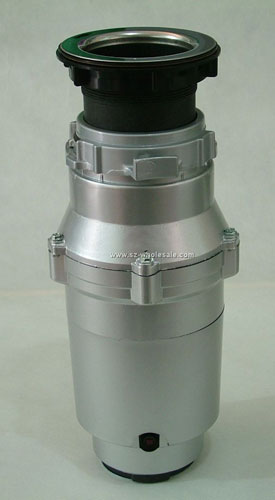

    The Costco Titan food waste disposer has to be the cheapest made disposer on the planet.
    I didn't know they could use so much plastic in something that was supposed to grind up food waste.
    One big problem I saw when troubleshooting a problem with one, was the small diameter of the dishwasher inlet. It was so small, that it backed up water onto the kitchen counter through the air gap.
    Any disposer sold at a home center would be better than this, and for less money.
    Now that I've seen one, I would never install one for a customer.
    A much better disposer would be a Insinkerator Badger five,
    Or if you want a better one, the Insinkerator Pro Essential.
    Yes, that's what you are looking at.
    Very much plastic on the Costco Titan.
    If you want to see contrasting reviews, check out the TITIAN PREMIUM T-1060. It seems that some people are happy that it powers on, and then there are those that removed them after a few months when they lost their new car smell.
    Dec 2007
    7,461
    Which one is it? Chinese junk I assume..

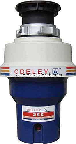

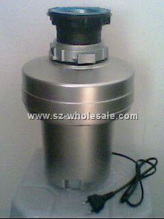

    Looking at the pics of those disposals, they remind me of the orange Dispos-All's...I think were made by G.E..
    Anyway...another cheapo is a Chinese-made Eastman disposal. Plastic flanges, weird buckle and collar to lock in onto the flange.
    23,562
    Default disposers
    They do not make them, they just have their names put on it. By looking at the mounting system you can identify the manufacturer, regardless of the name on it.

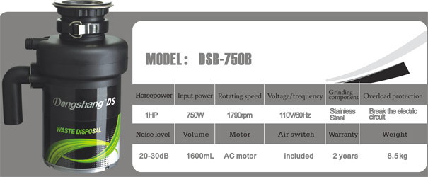

    Hi, everyone. I am new to this place. But i know more about Chinese products.
    I have been helping people sourcing quality products from China in the past, and i have been very successful.
    There are bad factories providing bad products of course, but there are also good factories providing quality products. you just need to be careful how you choose your products. I once helped people sourcing Dengshang Garbage disposal from China, it was a good experience. I don't know how to post pictures here, so i will just leave their site for your reference. www.cndengshang.com

    9,003
    Quote Originally Posted by Restlis View Post
    If anyone need profeesional help, let me know.
    If you want to help the chinese industry, someone needs to give them a wake up call. There will be a revolt in this country against the CRAP that is being sold here. Just heard on the news that they killed off several more babies over there because unscrupulous milk vendors slip stuff into the milk to save money. If they are willing to do that to the children in their own country, what will they get away with on export???
    Well. I know lots of bad stuffs are happening in China. And you can not just rule all good stuffs out just because of some bad stuffs. Even in USA, there are bad things happening all the time. People would do anything for money, not just in China.
    The key is to know who you are dealing with, choose your partner careful. And that is where i come to play ... helping people choose.. I didn't mean to advertise for myself. But i just want people to know
    not all things happening in China are bad...And not all things happening in USA or EU are good...
    FYI, I am not helping Chinese industry. I am helping myself get more business, to help more people. Becase there seems to be lots of people buying from China all the time.
