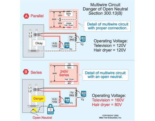

    It could very well be an open neutral. The neutral carries any imbalance from the 2 hots. The neutral and ground are bonded at the panel and any imbalance should go back to the transformer on the center tap via the neutral. If the neutral is open the ground becomes current carrying which is probably what you are seeing...

    That was a classic case of an open neutral, here is a picture of what actually happens in this case. Just FYI, you should really use an amprobe before you disconnect water mains and such, it could save your life.
    This picture shows a multiwire branch circuit, but a residential service is the same idea.
    Around my parts everyone has a well, so when someone has an open neutral, its pretty obvious from the get go. Since the current will not travel through the ground to good. Unlike city water where the problem could go unnoticed for years.
