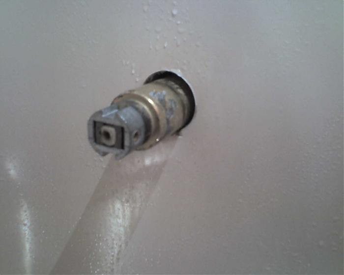

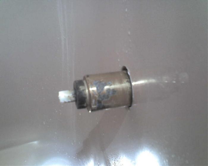

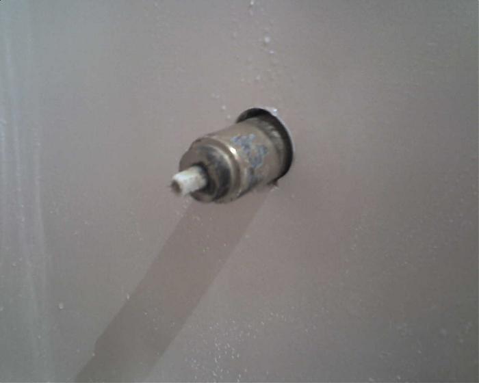

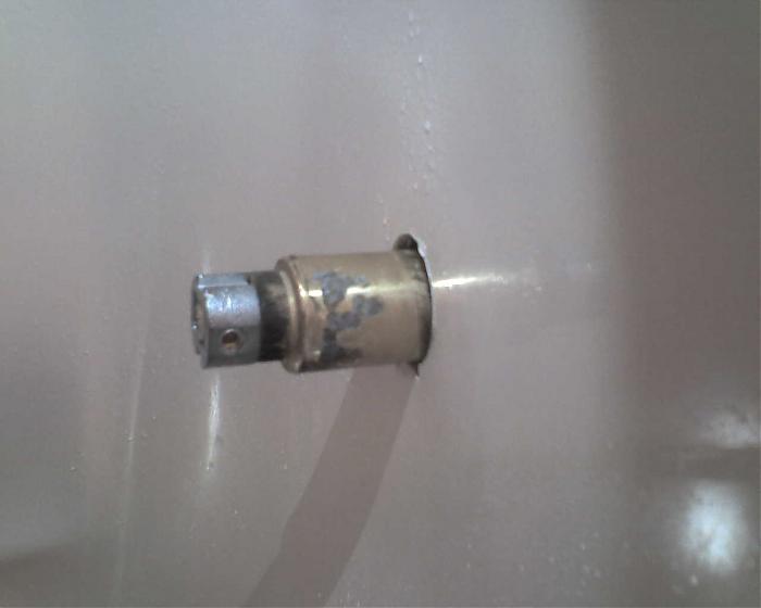

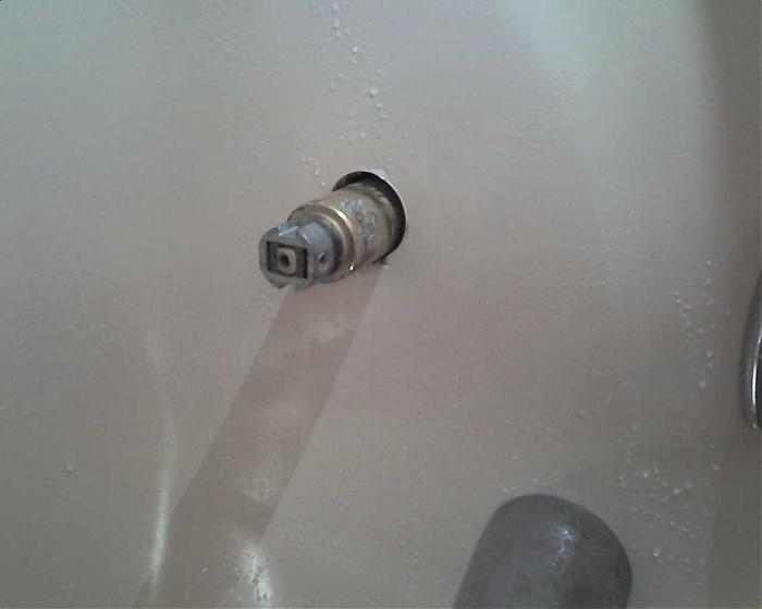

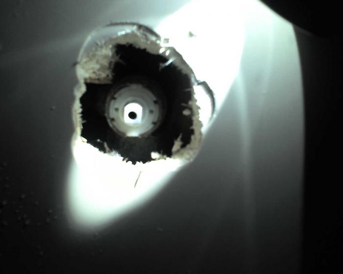

I am trying to stop a leak in my shower/tub faucet, but I can't find any markers telling me who makes this thing. I have also never seen an assembly like this so I am stumped. I have just moved into this house, so I don't know the history here, but I know it was built in 1990, so the fixtures shouldn't be any older than that. I have attached pictures with the handles removed.
Also, it is a double handle and the brass that you see is not a sleeve, but is solid.

I think the point is from the supplied pictures, it's really hard to tell!
kd0303
It's hard to tell in person too ;) I've added new pics, but without a digital camera I don't know how much better I can get for you.

The silver piece is a set-screwed on handle adapter. I don't recognize it...could be a generic? The stem looks like it could be Kohler, but that is just a stab.
Redwood
7,335
13
My thought is kohler too with a fits all handle adapter.
If you remove the stems and take a picture we'd probably have a better idea...
Much better pictures now thanks for redoing them.
kd0303
The handles are definitely generic...I just wasn't sure if the silver piece was a part of that kit or not, so I left it on for the pics. I'm not sure how to get the stems loose and I that was partly why I was trying to figure out the manufacturer, so I might have a better idea on how it comes out. I have kohler in our second bathroom and there is a hollow aluminum sleeve on those stems that unscrews. This set is solid all the way back and I am having trouble seeing any way to get at it with a stem wrench or anything. Incidentally, the scratches on the stems look like they are from someone trying to grab hold and turn with a pair of pliers.

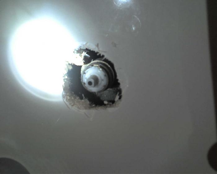

Ok, new development. I put a pair of vise grips on the stem just to see what would happen even though the thing is completely round, and lo and behold it screwed right off. Now I have a new picture of what was beneath and wonder if someone may be able to identify the brand from these new pics or let me know how to get it out of there.
Redwood
7,335
13
Have you got the water off?
Next step is to remove the stem and take it down to see about matching it up.
kd0303
Points to Redwood for correctly identifying the Coralais style Kohler cartridge. Changed them out and no more leak. Now if I want to change out handles and such, will any double handle from the Coralais line match up correctly to the valve body?
