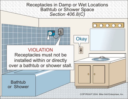

While we're at it, I found a photo of something else you folks might find amusing. I know it's not a load center, but I think you'll all still find it interesting. Who can spot the real safety issue here? Look closely if you have to - it is electrical in nature.
Looking closer at this photo I realise it's impossible to tell, but the switch next to the shower also happens to have an outlet right next to it. A switch is fine if I recall correctly, but an outlet? Err.
Yes, its legal, it cannot be over the tub, but directly right next to it is perfectly fine.

Chris ,this may fly in Conn.
It wouldn't in SF Ca. In addition to the NEC AND UPC We have many amendments to both. That's garbage work,where I come from!:D

Outlets in a bathroom are (should be) on a GFCI. And you are pretty darn safe with these! So not to worry...

I can say that isn't on a GFCI, but that's a super easy fix at least.
Keep in mind that if wired to the load wires of a GFCI any downstream outlets ARE protected by the GFCI. The easiest way to check this is to use the test button on the GFCI, and see if that outlet has any power.

Done. That bathroom has no GFCI. The other bathroom does, but not this one. I'll take care of it.
