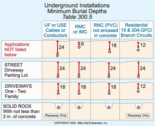

    What does the code specify as the minimum depth of burial for UF cable.The cable is 12/2 UF(direct burial).Burial in the trench will be unprotected.It will be protected with a 20a GFCI breaker.
    How many cables am I permitted to bury off of this circuit?
    What does the code call for, for protection ,as it makes it's way into and out of the ground?

    The answer is 12"

    Quote Originally Posted by Juan for the road View Post
    This is referenced in the NEC,I believe.Code experts?
    (D) Protection from Damage. Direct-buried conductors and cables shall be protected from damage in accordance with 300.5(D)(1) through (D)(4).
    (1) Emerging from Grade. Direct-buried conductors and cables emerging from grade and specified in columns 1 and 4 of Table 300.5 shall be protected by enclosures or raceways extending from the minimum cover distance below grade required by 300.5(A) to a point at least 2.5 m (8 ft) above finished grade. In no case shall the protection be required to exceed 450 mm (18 in.) below finished grade.
    (2) Conductors Entering Buildings. Conductors entering a building shall be protected to the point of entrance.
