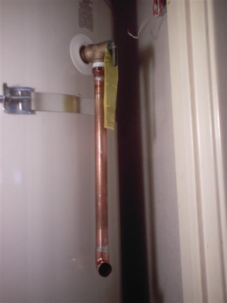

    Hi everyone I've been lurking for awhile and have enjoyed the tips. Well...I installed by water heater today. From reading this forum I decided upon a Rheem. Install went pretty smooth. But before my questions, I do have to share a bit of my stupidity. I hooked up everything, water, gas, vent, earthquake straps, (Chino Hills, CA). tested everything, lit the pilot and it stayed on like it should. Turned the temperature control to 120° and nothing. Would not fire up. I sat thinking what could be wrong. After about 20 mins. and no fire I figured it must be a bad thermostat. I figured I'd have to call Rheem on Monday. That was until my neighbor and his wife came over and after about a minute of them staring at the WH, the wife asks shouldn't this knob be tuned to on not pilot. Geez, I'm a moron. Works like a champ now.
    My questions now. The T&P valve is dripping. Could this be a bad valve? Second, When running the pipe from the T&P valve can a flex line be used or does it have to be hard piped?

    The TP valve should have been replaced with the tank. It is possible the TP is malfunctioning, but it sounds more like another problem. Do you have a pressure regulator valve on your water supply? If you do, you also must have a thermal expansion tank installed between the PRV and the water heater and it must be pressure-matched to the PRV. If you do have a PRV but do not have an expansion tank, because water expands as it heats it must have a place to expand to. If there is no PRV then the city water main absorbs this expansion and that's that. However, if you have a PRV, it has a check valve built in that prevents this expanded water from passing into the city main so a thermal expansion tank is needed. Without this tank or if the one you have is not set right or has failed, because the expanded water has no where to be absorbed, it trips the TP valve. The TP requires a hard pipe to the floor.

    I would install an expansion tank. It sounds like you have done everything else right. You could change the t&p, but that might be a waste of money. The T&P blow off can be run with hard plastic. The box stores sell the ready made ones.

    The T&P discharge water will be 200+ degrees if it operates. There is NO plastic that is approved at that temperature, which also has a FULL 3/4" i.d. as required by the code.

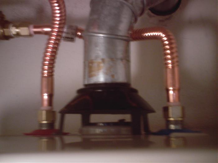

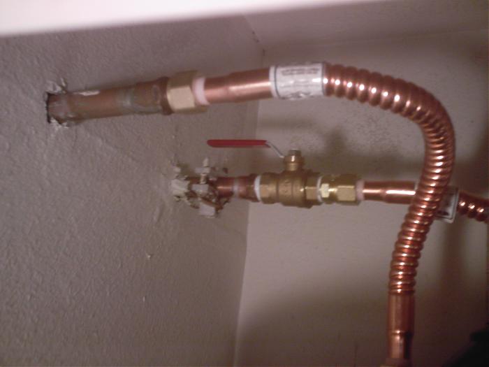

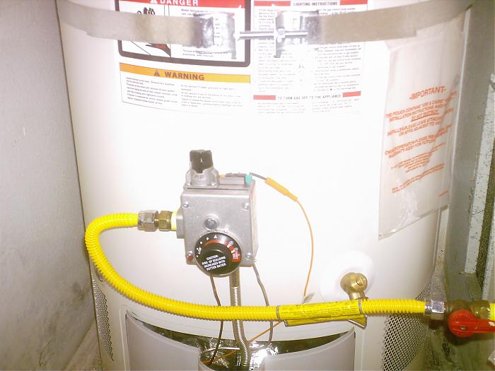

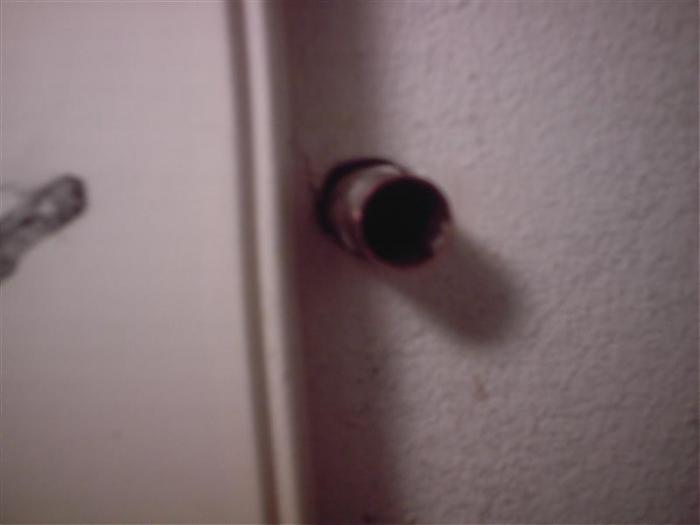

    Here are some pictures for your opinions. If you notice I have not finished the piping on the TP valve, I didn't want to finish the hook up until I figured out what was wrong with the dripping. If you notice the small stub in the other picture, that is where the TP valve gets attached.

    Ok These Are The Problems I See;
    #1 You Need Sheet Metal Screws At Least (3) If Possible In Each Joint Of The Single Wall Vent Pipe, In Case A Minor Earthquake ! !
    So The Vent Doe's Not Come Loose And Poison The Family ! !
    #2 Yes You Can Use A Water Heater Flex To Connect The T & P Drain
    "but" Check With Your City Officials On This,
    #3 Where You Have The Cold Water Flex Go Back To H.d. And Get A 3/4" Brass Tee And One Brass X Close Nipple This Allows You To Install Thermal Expansion Tank There, If Not Enough Room Get A
    2nd. Brass Nipple And Strap Tank To Sidewalls Being Sure To Hit A Stud With A Second Earthquake Strap Kit And Use A Water Flex To Connect It Together,
    The Thing You Must Know About Plumbing The Codes Get Updated All The Time So What Was Allowed At The Time Of The Old Heater
    Install Is Not A Approved Way To Install A New Water Heater To Todays Code ! ! !
    Yes The Device You Describe On Your Front Water Service Is The Prv. This Doe's Have A Internal Bypass To ALLOW Hot Water To Flow Into Street But The Chino Hills Area Has Very High Street Water Pressure ( Because Of Those Pesky Santa Ana Summer Fires )
    So Because Street Pressure Is At Or Higher Then The The T & P Relief Setting Of 150 Psi. You Need The Thermal Expansion Tank
    To Test This Get A Double Needle Pressure Gage And Leave On The Wtr/htr Drain Over Nite,
    You Will Find That After 10m If Not Before The Water Pressure Will Go Up! !
